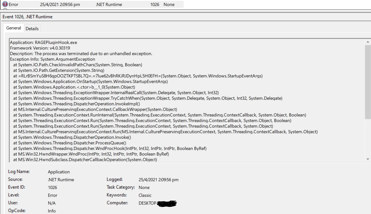

Hi Support, I'm getting this error CLR20r3 and "KernelBase.dll" when I try to play GTA V, I have contacted Microsoft Support many times before and they've had helped me reset my pc, update it and many more but the error won't stop. I have entered 3 errors messages from both "Problem Details and Event Viewer". I have tried uninstalling .NetFramework and reinstalling it but it didn't solve the error messages

Also this error is taken from "Event Viewer" with the same time of crash as the first event viewer error message
Application: RAGEPluginHook.exe
Framework Version: v4.0.30319
Description: The process was terminated due to an unhandled exception.
Exception Info: System.ArgumentException
at System.IO.Path.CheckInvalidPathChars(System.String, Boolean)
at System.IO.Path.GetExtension(System.String)
at =RLrBSmYuS8H6gpOOZTKPTSBL7Q=.=7lue62vBhRKJRJDynHpL5H0EFH=(System.Object, System.Windows.StartupEventArgs)
at System.Windows.Application.OnStartup(System.Windows.StartupEventArgs)
at System.Windows.Application.<.ctor>b__1_0(System.Object)
at System.Windows.Threading.ExceptionWrapper.InternalRealCall(System.Delegate, System.Object, Int32)
at System.Windows.Threading.ExceptionWrapper.TryCatchWhen(System.Object, System.Delegate, System.Object, Int32, System.Delegate)
at System.Windows.Threading.DispatcherOperation.InvokeImpl()
at MS.Internal.CulturePreservingExecutionContext.CallbackWrapper(System.Object)
at System.Threading.ExecutionContext.RunInternal(System.Threading.ExecutionContext, System.Threading.ContextCallback, System.Object, Boolean)
at System.Threading.ExecutionContext.Run(System.Threading.ExecutionContext, System.Threading.ContextCallback, System.Object, Boolean)
at System.Threading.ExecutionContext.Run(System.Threading.ExecutionContext, System.Threading.ContextCallback, System.Object)
at MS.Internal.CulturePreservingExecutionContext.Run(MS.Internal.CulturePreservingExecutionContext, System.Threading.ContextCallback, System.Object)
at System.Windows.Threading.DispatcherOperation.Invoke()
at System.Windows.Threading.Dispatcher.ProcessQueue()
at System.Windows.Threading.Dispatcher.WndProcHook(IntPtr, Int32, IntPtr, IntPtr, Boolean ByRef)
at MS.Win32.HwndWrapper.WndProc(IntPtr, Int32, IntPtr, IntPtr, Boolean ByRef)
at MS.Win32.HwndSubclass.DispatcherCallbackOperation(System.Object)
at System.Windows.Threading.Dispatcher.LegacyInvokeImpl(System.Windows.Threading.DispatcherPriority, System.TimeSpan, System.Delegate, System.Object, Int32)
at MS.Win32.HwndSubclass.SubclassWndProc(IntPtr, Int32, IntPtr, IntPtr)
at MS.Win32.UnsafeNativeMethods.DispatchMessage(System.Windows.Interop.MSG ByRef)
at System.Windows.Threading.Dispatcher.PushFrameImpl(System.Windows.Threading.DispatcherFrame)
at System.Windows.Application.RunDispatcher(System.Object)
at System.Windows.Application.RunInternal(System.Windows.Window)
at =RLrBSmYuS8H6gpOOZTKPTSBL7Q=.=Y2m68hA60EzlLqN5QLgZkFhkA=()

  1. cheong00 3,486 Reputation points Volunteer Moderator
    2021-04-12T01:07:53.733+00:00
    From there information given, I suspect your game is trying to load a plugin/mod that have bug so that it try's to access your drive with illegal characters in path.
    You had better remove all plugin/mod in the game to try again, then add back one by one and see which one caused the trouble.
