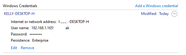

When accessing the laptop from the desktop, I was prompted for network credentials, so I entered my microsoft account username and password, no issues.
When accessing the desktop from the laptop, I was prompted for network credentials and the same credentials don't work. I changed the setting to turn off password protection, but accessing both computers still require a password. The microsoft username and password still work for accessing the laptop, but not the desktop.
I followed some internet troubleshooting which advised to use the IP address as the computer name and username and then create a password. This has allowed me access to the computer on the network, but as above, I can't see any users. I don't know if the credentials are causing this issue.

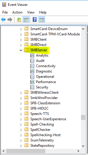

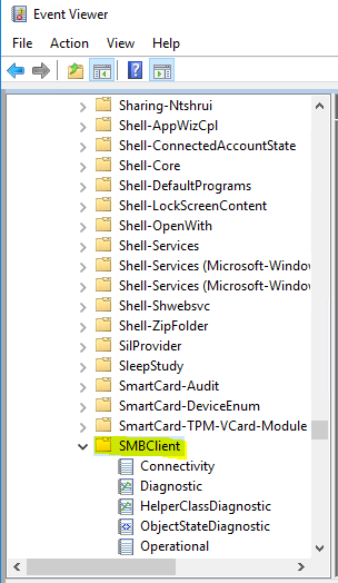

    What's the exact error message when you cannot access the desktop from laptop? Please also check laptop's SMB client log and desktop's SMB server log to see if there are something related for us to troubleshooting.

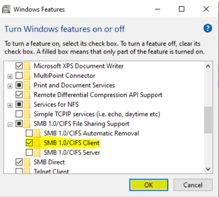

    1.Enable the SMB 1.0 support on laptop by enabling the following Windows features from the Control Panel:

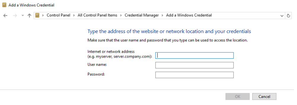

    2.Manually add username/password for UNC path in windows credential manager, see if it can work.

    To get past this, I followed instructions on the internet to assign credentials using my IP address. i am wondering why I had to do this in the first place and why my microsoft account login/password were my network credentials for the laptop and not the desktop. Nonetheless, I have bypassed the sign in error by renaming the network credentials as my IP address - see below (and this is logged in the laptop's network credentials referencing the desktop).
    1. Regarding your other instructions, I opened the client and server SMB logs, but there were no directions on what to look for. Please let me know if there is any information I should be finding in here to revert back to you.
    2. Re windows features - client and automatic removal were already turned on for the laptop, but none were turned on for the desktop. I checked on client and automatic removal and restarted the desktop. After restart, I connected using previously mentioned network credentials, but still does not show the user and connected files to the user account.

    In addition, you might try to create a shared folder on the desktop machine and give the Microsoft account Share Permissions and Security Permissions on the shared folder. See if you can use Microsoft account to access the share.
