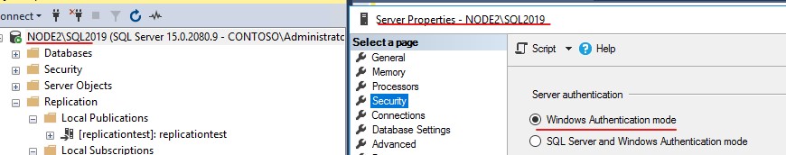

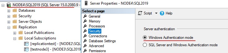

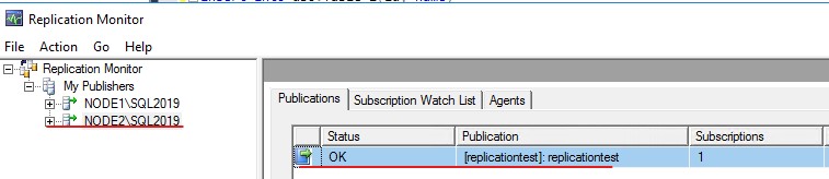

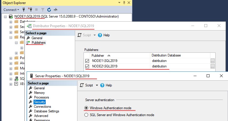

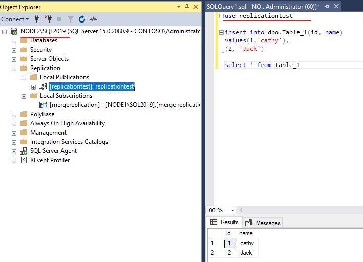

    I check this in my environment. Node 2 is Publisher server, Node 4 is subscriber server, Node 1 is remote distributor server.

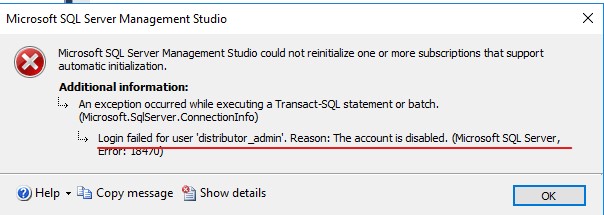

    > is the pub and dist still using the 'distributor_admin' sql login for repl connections... and does the repl work even when distributor_admin is disabled.
    No, it failed after disabled distributor_admin account.
