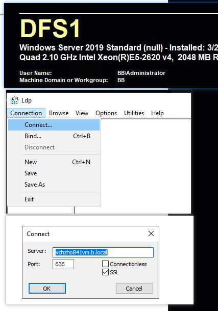

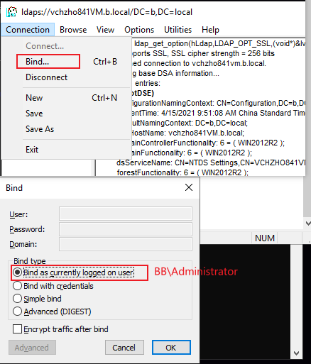

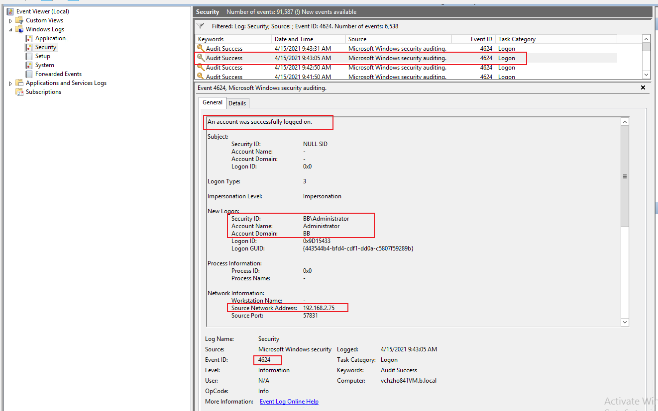

    2021-04-15T01:56:26.153+00:00
    Hello @matteu31 ,
    Thank you for posting here.
    Here is a test in my lab, I can audit LDAPS connections successfully.
    Here are the steps for your reference.
    I have a forest/root domain b.local (one DC named vchzho841vm) and a child domain bb.b.local (one DC dfs1, IP address192.168.2.75).
    1.On DC in child domain, I logged on this DC using domain Administrator credential in child domain.
    2.And I open ldp.exe (port 636, SSL)and connect to DC in the root doamin.
    3.Bind with BB\administrator.
    4.Then query someghing.
    5.On DC the root domain, open Event Viewer and I can see Event ID 4624 with source IP and credential.

  2. matteu31 502 Reputation points
    2021-04-15T07:05:58.243+00:00
    Hello
    Thank you for your answer.
    What you show here is audit connection but not ldaps only. 4624 is created when you logon with ldap also.
    The idea is to identify only ldaps connections.

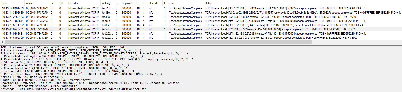

    Let's first be clear about what you want - do you want to log which clients use LDAP and TLS or just the clients that use LDAP and TLS by connecting to port 636? Connecting to port 636 is deprecated (see, for example, https://www.openldap.org/faq/data/cache/605.html) and the LDAP StartTLS is the preferred method (first connect to port 389 and then send a StartTLS request).
    If you want to log clients connecting to port 636, then logging traffic at the network level is probably the easiest way and can be done over weeks and months (the amount of data is modest). One way of doing this would be to issue the command:
    logman start LDAPS-Audit -ets -p Microsoft-Windows-TCPIP ut:TcpipListener -o LDAPS-Audit.etl
    This captures one event for each TCP "accept". It will log events for all ports, so it will need to be filtered for port 636. The event includes both local and remote addresses and ports and that is all that you seem to need.
