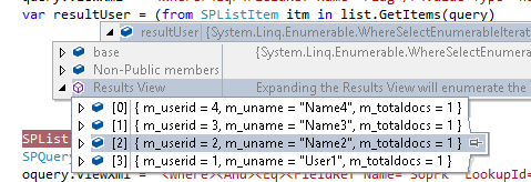

I have created Linq query to extract data from 2 lists,
Suppose have 2 lists :
List A and , List B
Solution Required: want to retrive those data from list A ,which is not present on list B.
attached is the code image
thanks

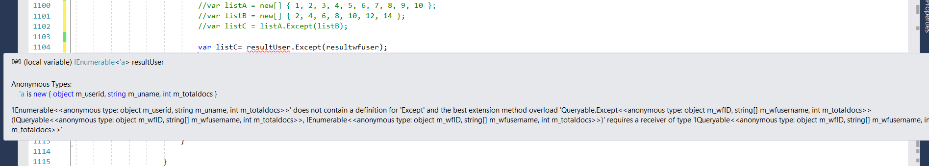

    Hi @Mohammad Qasim ,
    If want to filter out resultUser "m_userid" not equal to resultwfUser "m_wfID", modify to this:
    var ListC = resultUser.Select(u=>u.m_userid).Except(resultwfuser.Select(x => x.m_wfID));
    But the above will only return m_userid as using Select.
    Another better way will like this:
    var ListD = resultUser.Where(a => !resultwfuser.Select(b => b.m_wfID).Contains(a.m_userid));
    This will return the who field which meets condition.

    Use the Except method to return everything in one list that is not in the second list.
       var listA = new[] { 1, 2, 3, 4, 5, 6, 7, 8, 9, 10 };
       var listB = new[] { 2, 4, 6, 8, 10, 12, 14 };
       var listC = listA.Except(listB);
    Note that it uses equality comparison, like Union and other methods, so it is possible you'll need to define a custom IEqualityComparer implementation to do the comparison based upon the rules you want to use.
    In your case you're trying to do this via a join. As discussed in the docs join is equality only. To do a non-equality you can refer to this article but I think Except is easier.
