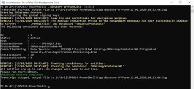

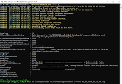

    Executing the Failover Process
    1.Restore the 4+ SQL databases (WFResourceManagementDb, WFInstanceManagementDb, SBGatwayDatabase, SBMessageContainer01 – n) from prod_SQL to DR_SQL.
    2.Install WFM in DR, If you were doing cold standby, then you need to install (but not configure) the SB/WF bits from Web Platform Installer.

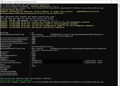

    3.Restore the SBFarm, SBGateway, and MessageContainer databases and settings (do this on only one WFM node)

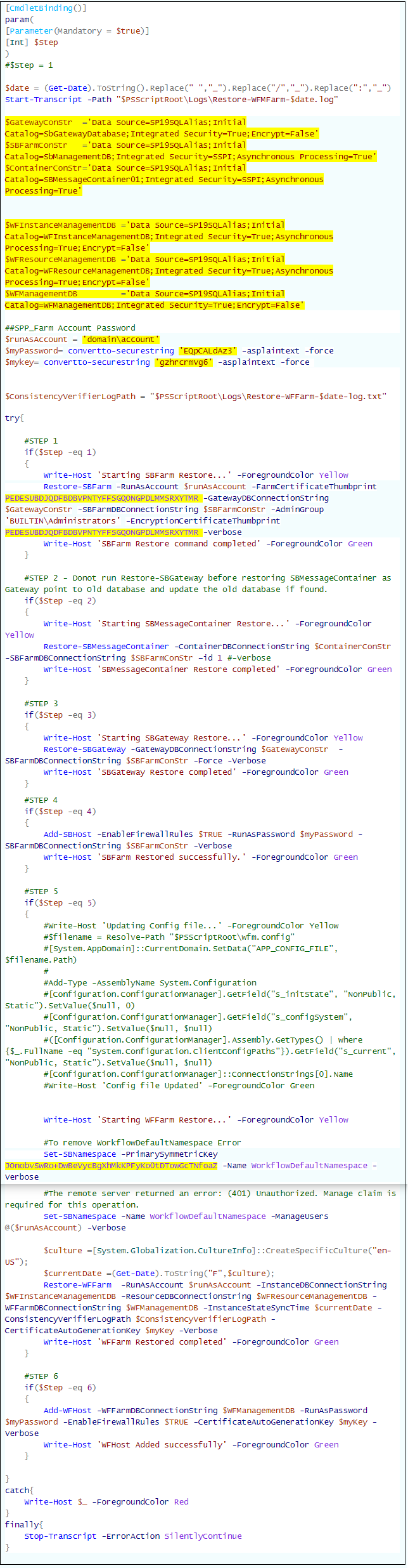

    Save the below the Restore-WFMFarm.ps1 script and update the highlighted values. Open SharePoint Manager PowerShell as run as administrator and navigate to the folder where script is placed.
    Restore-SBFarm
    cd ****
    .\Restore-WFMFarm -Step 1

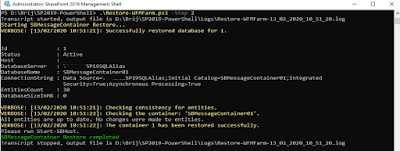

    Restore-SBMessageContainer
    .\Restore-WFMFarm -Step 2
    Restore-SBGateway
    .\Restore-WFMFarm -Step 3

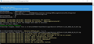

    4.Again, using powershell, run Add-SBHost on each node of the farm.
    Add-SBHost
    .\Restore-WFMFarm -Step 4
    5.If you used auto-generated certificates for the WFFarm in prod, then when you restore the WFFarm you will auto-generate new ones. However this also means that you may need to restore the PrimarySymmeticKey to the new SBNamespace.

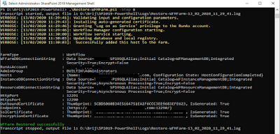

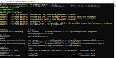

    6.At this point, restore the WFFarm using powershell (do this on only one WFM node)
    Restore-WFFarm
    .\Restore-WFMFarm -Step 5
