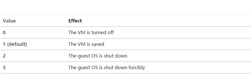

    3) You can run command to try to stop, turn off or remove your VM:
    -Get-ClusterResource "Virtual Machine" | Set-ClusterParameter OfflineAction value

    4) When I run this command: Get-ClusterResource "Virtual Machine" | Set-ClusterParameter OfflineAction 0
    I have this error: "An error occurred while opening the resource <<VMName>>".
