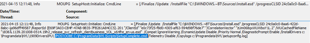

In the CMD file i am adding some registry keys and running a PS script to remove APPX and APPXPro packages.
After the upgrade is complete i do see log directory created and i do see settings in the setupact.log file.
MOUPG SetupHost::Initialize: CmdLine = [/Finalize /Update /InstallFile "C:\$WINDOWS.~BT\Sources\Install.esd" /progressCLSID 24c0a0c0-8aa6-422d-8abc-1a96dff49587 /ReportId {E69F3A03-CB4F-47AB-9B35-7FB261A84CC5}.201 "/ClientId" "e0c73f25-f8d0-4305-af63-594d98f76de7" "/CorrelationVector" "zUm068qxWUWboY1L.2" /WUCachedFileName "18363.1139.201008-0514.19h2_release_svc_refresh_clientbusiness_VOL_x64fre_en-us.esd" /Compat IgnoreWarning /DynamicUpdate Disable /Priority Normal /DiagnosticPrompt Enable /InstallDrivers c:\Programdata\NYL\1909DriversIPU\ /POSTOOBE C:\ProgramData\NYL\Scripts\SetupComplete.cmd /Telemetry Disable /Copylogs c:\Programdata\NYL\setupconfig.log]
The problem is my cmd file never runs and i cant figure out why.
Any help what have i missied?

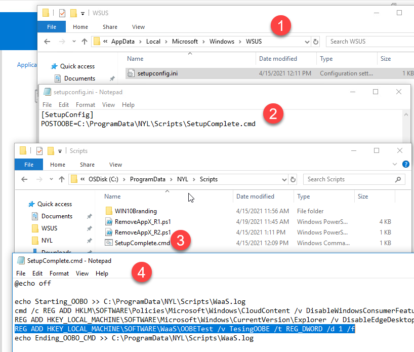

  3. MF_EndPoint 2 Reputation points
    2021-04-20T14:14:51.907+00:00
    I changed the CMD file to only add a registry key and a log file. but its not running.
    Is there a way to troubleshoot this issue?
    Any way to check or verify before before the reboot? Or only after the reboot setupact.log is generated?
    Thank you

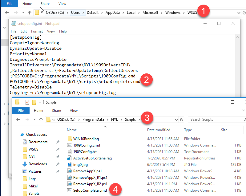

  5. MF_EndPoint 2 Reputation points
    2021-04-27T15:41:56.457+00:00
    I have been testing manually by moving content from 1909 iso and running setup.exe /ConfigFile "path to setupconfig.ini"
    And everything is working as expected. However when i am placing setupconfig.ini in the "%systemdrive%\Users\Default\AppData\Local\Microsoft\Windows\WSUS\ directory it never executed the SetupComplete.cmd file.
    I am running a feature update from SCCM using a "Feature update to Windows 10 (business editions), version 1909, en-us x64" Bulletin ID:
    Article ID: 3012973
    I am running a wrong patch? I cant figure out why its ignoring the batch file.91787-2021-04-27-11-39-21.png
