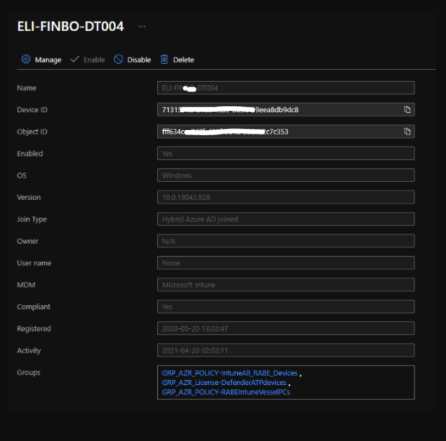

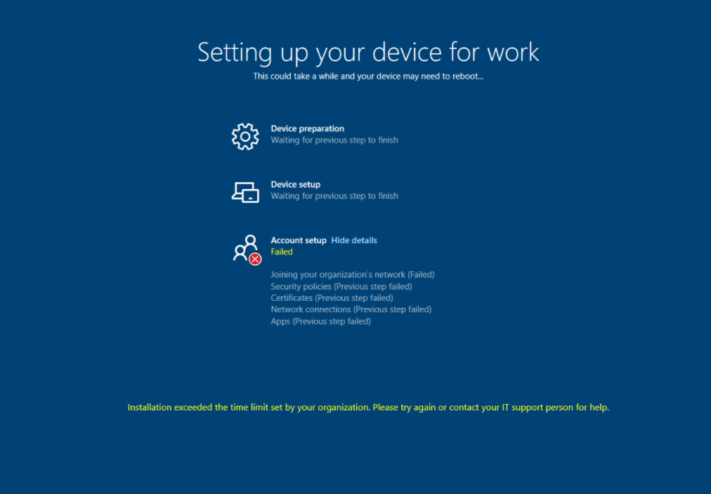

Greetings
As of last week we've had an increasing number of Windows 10 (20H2) getting stuck at the Intune Enrollment Status Page and reporting failed at "joning computer network". The computers are all hybrid joined without autopilot and EV reports them as AAD joined in Microsoft-Windows-User Device Registration/Admin. The error appears regardless of which user is logging in as long as it's an AD-account, local accounts can log in without errors and the domain user can log into another computer. So far we've tried to remove some of the computer accounts from both the on-prem domain, Intune and AAD without luck.

    Question #1: Below is a screenshot of the ESP page, the user cannot proceed but you can access task manager and sign in as a different user

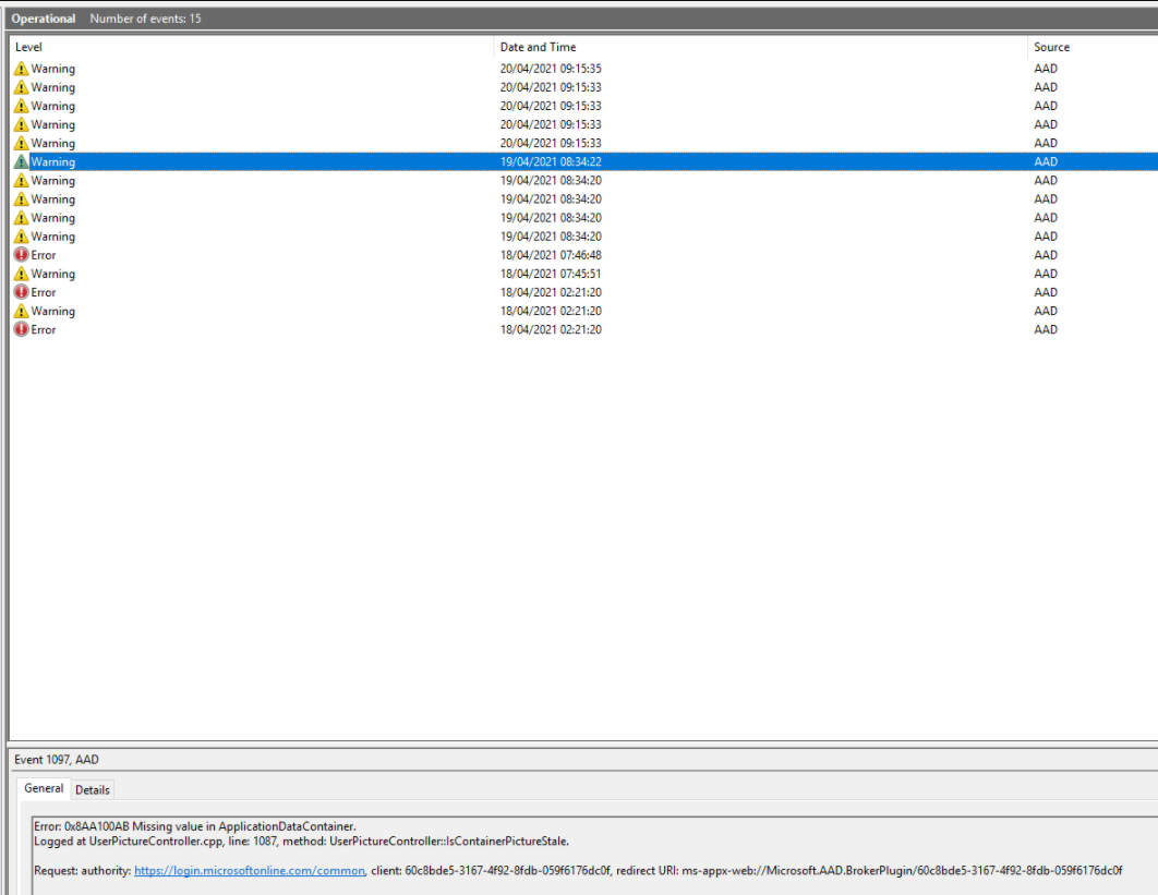

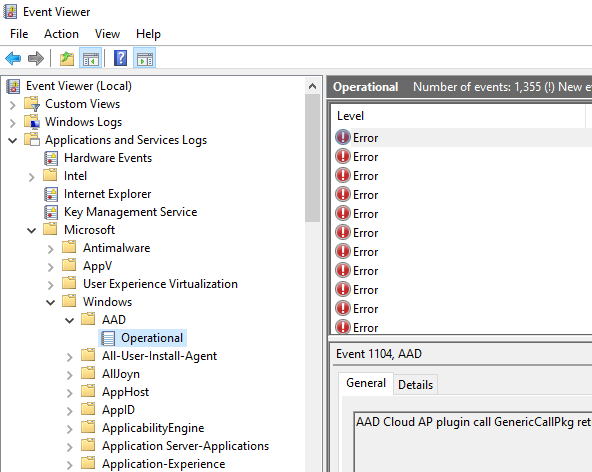

    Question #4: The AAD Event log on the PC show a few warnings but nothing that indicates a problem with the AAD computer account.

    From the pictures, I notice it is failed during join the organization in Account setup. Based on our research, this stage will obtain the Primary Refresh Token (PRT) and do authentication with Azure AD.
    https://learn.microsoft.com/en-us/troubleshoot/mem/intune/understand-troubleshoot-esp#account-setup
    I think the issue can be occurred when obtain PRT. To check on this, log analysis is necessary. As Q&A limitation, for such issue, we suggest to open case to troubleshoot this. Here is a link about opening case
