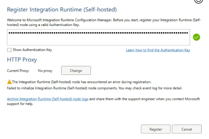

We recently configured our datafactory to collect data from 60 different branches of our business. We created 60 different integration runtime via the Data Factory UI and then installed IR on a local computer in each branch and copied over the registration key.
59 of these worked perfectly. On one single case though I get an error that says
"The integration Runtime (Self-hosted) node has encountered an error during registration.
Failed to initialize Integration Runtime (Self-hosted) node components. You may check event log for more detail."
I'm trying to debug this issue quickly if possible. I'm hoping it's something simple like a firewall configuration, I could not find this specific error anywhere on the internet. Has anyone seen this before?
The registration key is recognized on the runtime in question but then when I click "Finish" it just stays stuck in "initializing...." for a long time and then throws the error.
I tried uploading the xml log but for some reason I am unable to upload a small 80kb file. I went through the log myself and found that there's a few errors that occur when I face the above issue:
Authentication Key is not assigned yet.
Pre-validate token failed. Error code: AuthSasEffectiveInFuture
DEBUG: Pre-validate token failed. Error code: AuthSasEffectiveInFuture Activity ID: c8d641ad-d4e0-4127-9d14-0f62e33bd98d ErrorCode : AuthSasEffectiveInFuture, InnerException : null, ServiceTrace : Exception detail: Microsoft.DataTransfer.AuthService.Models.KmsApiException: ErrorCode : AuthSasEffectiveInFuture, InnerException : null, ServiceTrace : at Microsoft.DataTransfer.AuthService.Models.ClientTokenValidator.Validate(String token) at Microsoft.DataProxy.MidgardCore.HighAvailability.TokenValidator.Validate(String token) at Microsoft.DataProxy.MidgardCore.StartupStage.StartWorkerProcessStage.PreValidateToken(ConfigVariableManager configManager)
DEBUG: Failed in Retry Stage. ActivityID: c8d641ad-d4e0-4127-9d14-0f62e33bd98d Activity ID: c8d641ad-d4e0-4127-9d14-0f62e33bd98d ErrorCode : AuthSasEffectiveInFuture, InnerException : null, ServiceTrace : Exception detail: Microsoft.DataTransfer.AuthService.Models.KmsApiException: ErrorCode : AuthSasEffectiveInFuture, InnerException : null, ServiceTrace : at Microsoft.DataTransfer.AuthService.Models.ClientTokenValidator.Validate(String token) at Microsoft.DataProxy.MidgardCore.HighAvailability.TokenValidator.Validate(String token) at Microsoft.DataProxy.MidgardCore.StartupStage.StartWorkerProcessStage.PreValidateToken(ConfigVariableManager configManager) at Microsoft.DataProxy.MidgardCore.StartupStage.StartWorkerProcessStage.Run(ConfigVariableManager configManager, CancellationToken ct) at Microsoft.DataProxy.MidgardCore.StartupStage.StageRetry.<Run>d__18.MoveNext()
Create cloud endpoint listener failed. TransferMode: Streamed,
DEBUG: Create cloud endpoint listener failed. TransferMode: Streamed, Endpoint Information: e35c1065-eac7-4295-9cd4-a0a8b86919d6. Activity ID: 56b00c61-3aad-4178-88b4-42bfc37dcd98 Generic: ExpiredToken: The token is expired. Expiration time: '2020-06-15 21:46:57Z' ExpiredToken: The token is expired. Expiration time: '2020-06-15 21:46:57Z' Exception detail: Microsoft.ServiceBus.AuthorizationFailedException: Generic: ExpiredToken: The token is expired. Expiration time: '2020-06-15 21:46:57Z' ---> Microsoft.ServiceBus.Messaging.Amqp.AmqpException: ExpiredToken: The token is expired. Expiration time: '2020-06-15 21:46:57Z' at System.Runtime.ExceptionServices.ExceptionDispatchInfo.Throw() at Microsoft.ServiceBus.Common.AsyncResult.End[TAsyncResult](IAsyncResult result) at Microsoft.ServiceBus.Messaging.Amqp.AmqpObject.OpenAsyncResult.End(IAsyncResult result) at Microsoft.ServiceBus.Messaging.Amqp.AmqpObject.EndOpen(IAsyncResult result) at Microsoft.ServiceBus.Messaging.Amqp.DuplexAmqpLink.OnOperationComplete(AmqpObject link, IAsyncResult result, Boolean isOpen) --- End of stack trace from previous location where exception was thrown --- at System.Runtime.ExceptionServices.ExceptionDispatchInfo.Throw() at Microsoft.ServiceBus.Common.AsyncResult.End[TAsyncResult](IAsyncResult result) at Microsoft.ServiceBus.Messaging.Amqp.AmqpObject.OpenAsyncResult.End(IAsyncResult result) at Microsoft.ServiceBus.Messaging.Amqp.AmqpObject.EndOpen(IAsyncResult result) at System.Threading.Tasks.TaskFactory`1.FromAsyncCoreLogic(IAsyncResult iar, Func`2 endFunction, Action`1 endAction, Task`1 promise, Boolean requiresSynchronization) --- End of stack trace from previous location where exception was thrown --- at System.Runtime.ExceptionServices.ExceptionDispatchInfo.Throw() at System.Runtime.CompilerServices.TaskAwaiter.HandleNonSuccessAndDebuggerNotification(Task task) at Microsoft.ServiceBus.AmqpRelay.ConnectTask.<Start>d__4.MoveNext() --- End of inner exception stack trace --- at Microsoft.ServiceBus.AmqpRelay.ConnectTask.OnException(Exception exception) at Microsoft.ServiceBus.AmqpRelay.ConnectTask.<Start>d__4.MoveNext() --- End of stack trace from previous location where exception was thrown --- at System.Runtime.ExceptionServices.ExceptionDispatchInfo.Throw() at System.Runtime.CompilerServices.TaskAwaiter.HandleNonSuccessAndDebuggerNotification(Task task) at Microsoft.ServiceBus.AmqpRelay.<OpenAsync>d__70.MoveNext() --- End of stack trace from previous location where exception was thrown --- at System.Runtime.ExceptionServices.ExceptionDispatchInfo.Throw() at System.Runtime.CompilerServices.TaskAwaiter.HandleNonSuccessAndDebuggerNotification(Task task) at Microsoft.ServiceBus.RelayedOnewayListener.RelayedOnewayAmqpListenerClient.AmqpRelayedConnection.Open(TimeSpan timeout) at Microsoft.ServiceBus.RelayedOnewayListener.RelayedOnewayAmqpListenerClient.GetOrCreateConnection(Uri via, TimeSpan timeout) at Microsoft.ServiceBus.RelayedOnewayListener.RelayedOnewayAmqpListenerClient.Connect(TimeSpan timeout) at Microsoft.ServiceBus.RelayedOnewayTcpClient.EnsureConnected(TimeSpan timeout, Boolean isRetry) at Microsoft.ServiceBus.RelayedOnewayTcpClient.OnOpen(TimeSpan timeout) at System.ServiceModel.Channels.CommunicationObject.Open(TimeSpan timeout) at Microsoft.ServiceBus.RelayedOnewayListener.OnOpen(TimeSpan timeout) at Microsoft.ServiceBus.Channels.RefcountedCommunicationObject.Open(TimeSpan timeout) at Microsoft.ServiceBus.RelayedOnewayChannelListener.OnOpen(TimeSpan timeout) at System.ServiceModel.Channels.CommunicationObject.Open(TimeSpan timeout) at System.ServiceModel.Dispatcher.ChannelDispatcher.OnOpen(TimeSpan timeout) at System.ServiceModel.Channels.CommunicationObject.Open(TimeSpan timeout) at System.ServiceModel.ServiceHostBase.OnOpen(TimeSpan timeout) at System.ServiceModel.Channels.CommunicationObject.Open(TimeSpan timeout) at Microsoft.ServiceBus.WebSocketRelayedConnectionListener.Open(TimeSpan timeout) at Microsoft.ServiceBus.Channels.BufferedConnectionListener.Open(TimeSpan timeout) at Microsoft.ServiceBus.SocketConnectionTransportManager.OnOpen(TimeSpan timeout) at Microsoft.ServiceBus.Channels.TransportManager.Open(TimeSpan timeout, TransportChannelListener channelListener) at Microsoft.ServiceBus.Channels.TransportManagerContainer.Open(TimeSpan timeout, SelectTransportManagersCallback selectTransportManagerCallback) at Microsoft.ServiceBus.Channels.TransportChannelListener.OnOpen(TimeSpan timeout) at Microsoft.ServiceBus.Channels.ConnectionOrientedTransportChannelListener.OnOpen(TimeSpan timeout) at Microsoft.ServiceBus.SocketConnectionChannelListener`2.OnOpen(TimeSpan timeout) at System.ServiceModel.Channels.CommunicationObject.Open(TimeSpan timeout) at System.ServiceModel.Dispatcher.ChannelDispatcher.OnOpen(TimeSpan timeout) at System.ServiceModel.Channels.CommunicationObject.Open(TimeSpan timeout) at System.ServiceModel.ServiceHostBase.OnOpen(TimeSpan timeout) at System.ServiceModel.Channels.CommunicationObject.Open(TimeSpan timeout) at Microsoft.DataProxy.MidgardCore.ServiceBusBoundHostManager.CreateServiceBusListner(ServiceBusDataSU12CY13 sbData, IEnumerable`1 impContracts, TransferMode transferMode, ICollection`1 exList)
DEBUG: Unable to create cloud enpdoint listener. Error message: One or more errors occurred.. Activity ID: 56b00c61-3aad-4178-88b4-42bfc37dcd98 Generic: ExpiredToken: The token is expired. Expiration time: '2020-06-15 21:46:57Z' ExpiredToken: The token is expired. Expiration time: '2020-06-15 21:46:57Z' Generic: ExpiredToken: The token is expired. Expiration time: '2020-06-15 21:46:59Z' ExpiredToken: The token is expired. Expiration time: '2020-06-15 21:46:59Z' Exception detail: System.AggregateException: One or more errors occurred. ---> Microsoft.ServiceBus.AuthorizationFailedException: Generic: ExpiredToken: The token is expired. Expiration time: '2020-06-15 21:46:57Z' ---> Microsoft.ServiceBus.Messaging.Amqp.AmqpException: ExpiredToken: The token is expired. Expiration time: '2020-06-15 21:46:57Z' at System.Runtime.ExceptionServices.ExceptionDispatchInfo.Throw() at Microsoft.ServiceBus.Common.AsyncResult.End[TAsyncResult](IAsyncResult result) at Microsoft.ServiceBus.Messaging.Amqp.AmqpObject.OpenAsyncResult.End(IAsyncResult result) at Microsoft.ServiceBus.Messaging.Amqp.AmqpObject.EndOpen(IAsyncResult result) at Microsoft.ServiceBus.Messaging.Amqp.DuplexAmqpLink.OnOperationComplete(AmqpObject link, IAsyncResult result, Boolean isOpen) --- End of stack trace from previous location where exception was thrown --- at System.Runtime.ExceptionServices.ExceptionDispatchInfo.Throw() at Microsoft.ServiceBus.Common.AsyncResult.End[TAsyncResult](IAsyncResult result) at Microsoft.ServiceBus.Messaging.Amqp.AmqpObject.OpenAsyncResult.End(IAsyncResult result) at Microsoft.ServiceBus.Messaging.Amqp.AmqpObject.EndOpen(IAsyncResult result) at System.Threading.Tasks.TaskFactory`1.FromAsyncCoreLogic(IAsyncResult iar, Func`2 endFunction, Action`1 endAction, Task`1 promise, Boolean requiresSynchronization) --- End of stack trace from previous location where exception was thrown --- at System.Runtime.ExceptionServices.ExceptionDispatchInfo.Throw() at System.Runtime.CompilerServices.TaskAwaiter.HandleNonSuccessAndDebuggerNotification(Task task) at Microsoft.ServiceBus.AmqpRelay.ConnectTask.<Start>d__4.MoveNext() --- End of inner exception stack trace --- at Microsoft.ServiceBus.AmqpRelay.ConnectTask.OnException(Exception exception) at Microsoft.ServiceBus.AmqpRelay.ConnectTask.<Start>d__4.MoveNext() --- End of stack trace from previous location where exception was thrown --- at System.Runtime.ExceptionServices.ExceptionDispatchInfo.Throw() at System.Runtime.CompilerServices.TaskAwaiter.HandleNonSuccessAndDebuggerNotification(Task task) at Microsoft.ServiceBus.AmqpRelay.<OpenAsync>d__70.MoveNext() --- End of stack trace from previous location where exception was thrown --- at System.Runtime.ExceptionServices.ExceptionDispatchInfo.Throw() at System.Runtime.CompilerServices.TaskAwaiter.HandleNonSuccessAndDebuggerNotification(Task task) at Microsoft.ServiceBus.RelayedOnewayListener.RelayedOnewayAmqpListenerClient.AmqpRelayedConnection.Open(TimeSpan timeout) at Microsoft.ServiceBus.RelayedOnewayListener.RelayedOnewayAmqpListenerClient.GetOrCreateConnection(Uri via, TimeSpan timeout) at Microsoft.ServiceBus.RelayedOnewayListener.RelayedOnewayAmqpListenerClient.Connect(TimeSpan timeout) at Microsoft.ServiceBus.RelayedOnewayTcpClient.EnsureConnected(TimeSpan timeout, Boolean isRetry) at Microsoft.ServiceBus.RelayedOnewayTcpClient.OnOpen(TimeSpan timeout) at System.ServiceModel.Channels.CommunicationObject.Open(TimeSpan timeout) at Microsoft.ServiceBus.RelayedOnewayListener.OnOpen(TimeSpan timeout) at Microsoft.ServiceBus.Channels.RefcountedCommunicationObject.Open(TimeSpan timeout) at Microsoft.ServiceBus.RelayedOnewayChannelListener.OnOpen(TimeSpan timeout) at System.ServiceModel.Channels.CommunicationObject.Open(TimeSpan timeout) at System.ServiceModel.Dispatcher.ChannelDispatcher.OnOpen(TimeSpan timeout) at System.ServiceModel.Channels.CommunicationObject.Open(TimeSpan timeout) at System.ServiceModel.ServiceHostBase.OnOpen(TimeSpan timeout) at System.ServiceModel.Channels.CommunicationObject.Open(TimeSpan timeout) at Microsoft.ServiceBus.WebSocketRelayedConnectionListener.Open(TimeSpan timeout) at Microsoft.ServiceBus.Channels.BufferedConnectionListener.Open(TimeSpan timeout) at Microsoft.ServiceBus.SocketConnectionTransportManager.OnOpen(TimeSpan timeout) at Microsoft.ServiceBus.Channels.TransportManager.Open(TimeSpan timeout, TransportChannelListener channelListener) at Microsoft.ServiceBus.Channels.TransportManagerContainer.Open(TimeSpan timeout, SelectTransportManagersCallback selectTransportManagerCallback) at Microsoft.ServiceBus.Channels.TransportChannelListener.OnOpen(TimeSpan timeout) at Microsoft.ServiceBus.Channels.ConnectionOrientedTransportChannelListener.OnOpen(TimeSpan timeout) at Microsoft.ServiceBus.SocketConnectionChannelListener`2.OnOpen(TimeSpan timeout) at System.ServiceModel.Channels.CommunicationObject.Open(TimeSpan timeout) at System.ServiceModel.Dispatcher.ChannelDispatcher.OnOpen(TimeSpan timeout) at System.ServiceModel.Channels.CommunicationObject.Open(TimeSpan timeout) at System.ServiceModel.ServiceHostBase.OnOpen(TimeSpan timeout) at System.ServiceModel.Channels.CommunicationObject.Open(TimeSpan timeout) at Microsoft.DataProxy.MidgardCore.ServiceBusBoundHostManager.CreateServiceBusListner(ServiceBusDataSU12CY13 sbData, IEnumerable`1 impContracts, TransferMode transferMode, ICollection`1 exList) --- End of inner exception stack trace --- at Microsoft.DataProxy.MidgardCore.ServiceBusBoundHostManager.SpecifyServiceBusAddressList(ReadOnlyCollection`1 sbDataList) at Microsoft.DataProxy.MidgardCore.ConnectToServiceBusStage.<Run>d__4.MoveNext() ---> (Inner Exception #0) Microsoft.ServiceBus.AuthorizationFailedException: Generic: ExpiredToken: The token is expired. Expiration time: '2020-06-15 21:46:57Z' ---> Microsoft.ServiceBus.Messaging.Amqp.AmqpException: ExpiredToken: The token is expired. Expiration time: '2020-06-15 21:46:57Z' at System.Runtime.ExceptionServices.ExceptionDispatchInfo.Throw() at Microsoft.ServiceBus.Common.AsyncResult.End[TAsyncResult](IAsyncResult result) at Microsoft.ServiceBus.Messaging.Amqp.AmqpObject.OpenAsyncResult.End(IAsyncResult result) at Microsoft.ServiceBus.Messaging.Amqp.AmqpObject.EndOpen(IAsyncResult result) at Microsoft.ServiceBus.Messaging.Amqp.DuplexAmqpLink.OnOperationComplete(AmqpObject link, IAsyncResult result, Boolean isOpen) --- End of stack trace from previous location where exception was thrown --- at System.Runtime.ExceptionServices.ExceptionDispatchInfo.Throw() at Microsoft.ServiceBus.Common.AsyncResult.End[TAsyncResult](IAsyncResult result) at Microsoft.ServiceBus.Messaging.Amqp.AmqpObject.OpenAsyncResult.End(IAsyncResult result) at Microsoft.ServiceBus.Messaging.Amqp.AmqpObject.EndOpen(IAsyncResult result) at System.Threading.Tasks.TaskFactory`1.FromAsyncCoreLogic(IAsyncResult iar, Func`2 endFunction, Action`1 endAction, Task`1 promise, Boolean requiresSynchronization) --- End of stack trace from previous location where exception was thrown --- at System.Runtime.ExceptionServices.ExceptionDispatchInfo.Throw() at System.Runtime.CompilerServices.TaskAwaiter.HandleNonSuccessAndDebuggerNotification(Task task) at Microsoft.ServiceBus.AmqpRelay.ConnectTask.<Start>d__4.MoveNext() --- End of inner exception stack trace --- at Microsoft.ServiceBus.AmqpRelay.ConnectTask.OnException(Exception exception) at Microsoft.ServiceBus.AmqpRelay.ConnectTask.<Start>d__4.MoveNext() --- End of stack trace from previous location where exception was thrown --- at System.Runtime.ExceptionServices.ExceptionDispatchInfo.Throw() at System.Runtime.CompilerServices.TaskAwaiter.HandleNonSuccessAndDebuggerNotification(Task task) at Microsoft.ServiceBus.AmqpRelay.<OpenAsync>d__70.MoveNext() --- End of stack trace from previous location where exception was thrown --- at System.Runtime.ExceptionServices.ExceptionDispatchInfo.Throw() at System.Runtime.CompilerServices.TaskAwaiter.HandleNonSuccessAndDebuggerNotification(Task task) at Microsoft.ServiceBus.RelayedOnewayListener.RelayedOnewayAmqpListenerClient.AmqpRelayedConnection.Open(TimeSpan timeout) at Microsoft.ServiceBus.RelayedOnewayListener.RelayedOnewayAmqpListenerClient.GetOrCreateConnection(Uri via, TimeSpan timeout) at Microsoft.ServiceBus.RelayedOnewayListener.RelayedOnewayAmqpListenerClient.Connect(TimeSpan timeout) at Microsoft.ServiceBus.RelayedOnewayTcpClient.EnsureConnected(TimeSpan timeout, Boolean isRetry) at Microsoft.ServiceBus.RelayedOnewayTcpClient.OnOpen(TimeSpan timeout) at System.ServiceModel.Channels.CommunicationObject.Open(TimeSpan timeout) at Microsoft.ServiceBus.RelayedOnewayListener.OnOpen(TimeSpan timeout) at Microsoft.ServiceBus.Channels.RefcountedCommunicationObject.Open(TimeSpan timeout) at Microsoft.ServiceBus.RelayedOnewayChannelListener.OnOpen(TimeSpan timeout) at System.ServiceModel.Channels.CommunicationObject.Open(TimeSpan timeout) at System.ServiceModel.Dispatcher.ChannelDispatcher.OnOpen(TimeSpan timeout) at System.ServiceModel.Channels.CommunicationObject.Open(TimeSpan timeout) at System.ServiceModel.ServiceHostBase.OnOpen(TimeSpan timeout) at System.ServiceModel.Channels.CommunicationObject.Open(TimeSpan timeout) at Microsoft.ServiceBus.WebSocketRelayedConnectionListener.Open(TimeSpan timeout) at Microsoft.ServiceBus.Channels.BufferedConnectionListener.Open(TimeSpan timeout) at Microsoft.ServiceBus.SocketConnectionTransportManager.OnOpen(TimeSpan timeout) at Microsoft.ServiceBus.Channels.TransportManager.Open(TimeSpan timeout, TransportChannelListener channelListener) at Microsoft.ServiceBus.Channels.TransportManagerContainer.Open(TimeSpan timeout, SelectTransportManagersCallback selectTransportManagerCallback) at Microsoft.ServiceBus.Channels.TransportChannelListener.OnOpen(TimeSpan timeout) at Microsoft.ServiceBus.Channels.ConnectionOrientedTransportChannelListener.OnOpen(TimeSpan timeout) at Microsoft.ServiceBus.SocketConnectionChannelListener`2.OnOpen(TimeSpan timeout) at System.ServiceModel.Channels.CommunicationObject.Open(TimeSpan timeout) at System.ServiceModel.Dispatcher.ChannelDispatcher.OnOpen(TimeSpan timeout) at System.ServiceModel.Channels.CommunicationObject.Open(TimeSpan timeout) at System.ServiceModel.ServiceHostBase.OnOpen(TimeSpan timeout) at System.ServiceModel.Channels.CommunicationObject.Open(TimeSpan timeout) at Microsoft.DataProxy.MidgardCore.ServiceBusBoundHostManager.CreateServiceBusListner(ServiceBusDataSU12CY13 sbData, IEnumerable`1 impContracts, TransferMode transferMode, ICollection`1 exList)<--- ---> (Inner Exception #1) Microsoft.ServiceBus.AuthorizationFailedException: Generic: ExpiredToken: The token is expired. Expiration time: '2020-06-15 21:46:59Z' ---> Microsoft.ServiceBus.Messaging.Amqp.AmqpException: ExpiredToken: The token is expired. Expiration time: '2020-06-15 21:46:59Z' at System.Runtime.ExceptionServices.ExceptionDispatchInfo.Throw() at Microsoft.ServiceBus.Common.AsyncResult.End[TAsyncResult](IAsyncResult result) at Microsoft.ServiceBus.Messaging.Amqp.AmqpObject.OpenAsyncResult.End(IAsyncResult result) at Microsoft.ServiceBus.Messaging.Amqp.AmqpObject.EndOpen(IAsyncResult result) at Microsoft.ServiceBus.Messaging.Amqp.DuplexAmqpLink.OnOperationComplete(AmqpObject link, IAsyncResult result, Boolean isOpen) --- End of stack trace from previous location where exception was thrown --- at System.Runtime.ExceptionServices.ExceptionDispatchInfo.Throw() at Microsoft.ServiceBus.Common.AsyncResult.End[TAsyncResult](IAsyncResult result) at Microsoft.ServiceBus.Messaging.Amqp.AmqpObject.OpenAsyncResult.End(IAsyncResult result) at Microsoft.ServiceBus.Messaging.Amqp.AmqpObject.EndOpen(IAsyncResult result) at System.Threading.Tasks.TaskFactory`1.FromAsyncCoreLogic(IAsyncResult iar, Func`2 endFunction, Action`1 endAction, Task`1 promise, Boolean requiresSynchronization) --- End of stack trace from previous location where exception was thrown --- at System.Runtime.ExceptionServices.ExceptionDispatchInfo.Throw() at System.Runtime.CompilerServices.TaskAwaiter.HandleNonSuccessAndDebuggerNotification(Task task) at Microsoft.ServiceBus.AmqpRelay.ConnectTask.<Start>d__4.MoveNext() --- End of inner exception stack trace --- at Microsoft.ServiceBus.AmqpRelay.ConnectTask.OnException(Exception exception) at Microsoft.ServiceBus.AmqpRelay.ConnectTask.<Start>d__4.MoveNext() --- End of stack trace from previous location where exception was thrown --- at System.Runtime.ExceptionServices.ExceptionDispatchInfo.Throw() at System.Runtime.CompilerServices.TaskAwaiter.HandleNonSuccessAndDebuggerNotification(Task task) at Microsoft.ServiceBus.AmqpRelay.<OpenAsync>d__70.MoveNext() --- End of stack trace from previous location where exception was thrown --- at System.Runtime.ExceptionServices.ExceptionDispatchInfo.Throw() at System.Runtime.CompilerServices.TaskAwaiter.HandleNonSuccessAndDebuggerNotification(Task task) at Microsoft.ServiceBus.RelayedOnewayListener.RelayedOnewayAmqpListenerClient.AmqpRelayedConnection.Open(TimeSpan timeout) at Microsoft.ServiceBus.RelayedOnewayListener.RelayedOnewayAmqpListenerClient.GetOrCreateConnection(Uri via, TimeSpan timeout) at Microsoft.ServiceBus.RelayedOnewayListener.RelayedOnewayAmqpListenerClient.Connect(TimeSpan timeout) at Microsoft.ServiceBus.RelayedOnewayTcpClient.EnsureConnected(TimeSpan timeout, Boolean isRetry) at Microsoft.ServiceBus.RelayedOnewayTcpClient.OnOpen(TimeSpan timeout) at System.ServiceModel.Channels.CommunicationObject.Open(TimeSpan timeout) at Microsoft.ServiceBus.RelayedOnewayListener.OnOpen(TimeSpan timeout) at Microsoft.ServiceBus.Channels.RefcountedCommunicationObject.Open(TimeSpan timeout) at Microsoft.ServiceBus.RelayedOnewayChannelListener.OnOpen(TimeSpan timeout) at System.ServiceModel.Channels.CommunicationObject.Open(TimeSpan timeout) at System.ServiceModel.Dispatcher.ChannelDispatcher.OnOpen(TimeSpan timeout) at System.ServiceModel.Channels.CommunicationObject.Open(TimeSpan timeout) at System.ServiceModel.ServiceHostBase.OnOpen(TimeSpan timeout) at System.ServiceModel.Channels.CommunicationObject.Open(TimeSpan timeout) at Microsoft.ServiceBus.WebSocketRelayedConnectionListener.Open(TimeSpan timeout) at Microsoft.ServiceBus.Channels.BufferedConnectionListener.Open(TimeSpan timeout) at Microsoft.ServiceBus.SocketConnectionTransportManager.OnOpen(TimeSpan timeout) at Microsoft.ServiceBus.Channels.TransportManager.Open(TimeSpan timeout, TransportChannelListener channelListener) at Microsoft.ServiceBus.Channels.TransportManagerContainer.Open(TimeSpan timeout, SelectTransportManagersCallback selectTransportManagerCallback) at Microsoft.ServiceBus.Channels.TransportChannelListener.OnOpen(TimeSpan timeout) at Microsoft.ServiceBus.Channels.ConnectionOrientedTransportChannelListener.OnOpen(TimeSpan timeout) at Microsoft.ServiceBus.SocketConnectionChannelListener`2.OnOpen(TimeSpan timeout) at System.ServiceModel.Channels.CommunicationObject.Open(TimeSpan timeout) at System.ServiceModel.Dispatcher.ChannelDispatcher.OnOpen(TimeSpan timeout) at System.ServiceModel.Channels.CommunicationObject.Open(TimeSpan timeout) at System.ServiceModel.ServiceHostBase.OnOpen(TimeSpan timeout) at System.ServiceModel.Channels.CommunicationObject.Open(TimeSpan timeout) at Microsoft.DataProxy.MidgardCore.ServiceBusBoundHostManager.CreateServiceBusListner(ServiceBusDataSU12CY13 sbData, IEnumerable`1 impContracts, TransferMode transferMode, ICollection`1 exList)<---

  1. Sunil_CATO 106 Reputation points
    2020-06-16T00:37:27.813+00:00
    Hi again!
    I fixed the issue, I tried making sense of those logs and "AuthSasEffectiveInFuture" this caught my eye. I followed a hunch and checked timezone settings on that computer and realized the branch had been set to an incorrect timezone (they are UTC -0700 but they were set to UTC -0500) so to correct that the branch manager and manually edited the time to 2 hours back.
    This causes the authentication between Azure and the node to break.
    I feel so bad to have wasted my entire day and your time on such a silly issue, had the error code from Azure been "Check your system time" life would have been a little easier.
    Thanks so much for trying to help!
