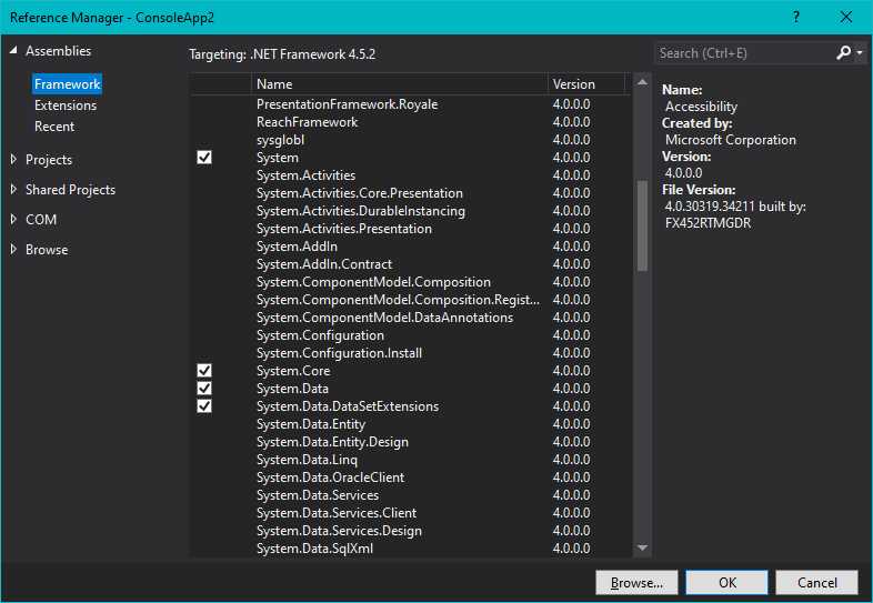

  1. Sam of Simple Samples 5,546 Reputation points
    2021-04-26T16:58:46.537+00:00
    Please update your tags to indicate C#.
    Ensure that your project still has System for a reference, as in:
    You can do that by selecting the Project menu then selecting Add Reference... then scroll down.
    If that is not the problem then does the problem occur if you create a new project?
