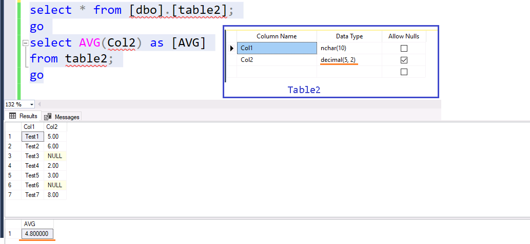

The practice is the opposite:
AVG(Col2) returns the 2 instead of ~2.7, whilst AVG(Col2) for another table with the Col2 = decimal returns the correct (decimal) result:
In other words it looks like the wording should read "the type of expression determines the return type" - NOT the "The evaluated result of expression determines the return type.*".

  1. Tom Cooper 8,486 Reputation points
    2021-04-26T15:09:31.223+00:00
    You understanding of the way it works is correct. Both the wording the documentation has and your wording mean the same. First SQL determines the datatype of the expression (before doing the AVG) and then uses the chart to determine the result of doing the AVG. If you are doing the AVG of a column, the datatype of the expression is just the datatype of the column. But if the expression is a calculation, it determines the datatype of that calculation and then uses that to determine the result of the AVG.

  3. Erland Sommarskog 121.9K Reputation points MVP Volunteer Moderator
    2021-04-26T21:55:50.913+00:00
    I interpret as "calculate the average and see what the value you've got
    Given the wording, this interpretation is not unreasonable. However, if I tell you that the data type of an expression is always static, you will realise that this is not what the documentation wants to say.
    The data type is always determined before the computation starts. More precisely, it is determined when the statement is compiled.
  4. MelissaMa-MSFT 24,221 Reputation points
    2021-04-27T01:42:04.14+00:00
    Hi @Mikhail Firsov ,
    "The evaluated result of expression determines the return type."
    You could also understand above as 'The return type is determined by the type of the evaluated result of expression'.
    Using your sample table and please refer some examples as below. Hope it could be a little helpful to you.
    select avg(col2) from Table1 --integer inside avg,result should be integer
    --2
    select avg(col2+0.0) from Table1 --float inside avg(add 0.0 which is a fast conversion to float),result should be float
    ----2.714285
    select cast(avg(col2) as decimal(5,2)) from Table1 --integer inside avg but convert result to decimal
    --2.00
    select avg(cast(col2 as decimal(5,2))) from Table1 --decimal inside avg,result should be decimal
    --2.714285
    select cast(avg(cast(col2 as decimal(5,2))) as decimal(5,2)) from Table1 --decimal inside avg and convert the result to specific decimal(5,2)
    --2.71
