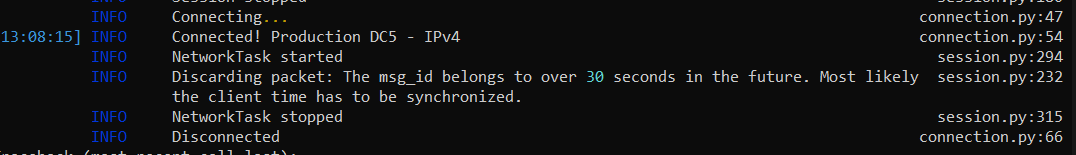

I am trying to run some python scripts but I am getting error as below.
Python Error: Discarding packet: The msg_id belongs to over 30 seconds in the future. Most likely the client time has to be synchronized.

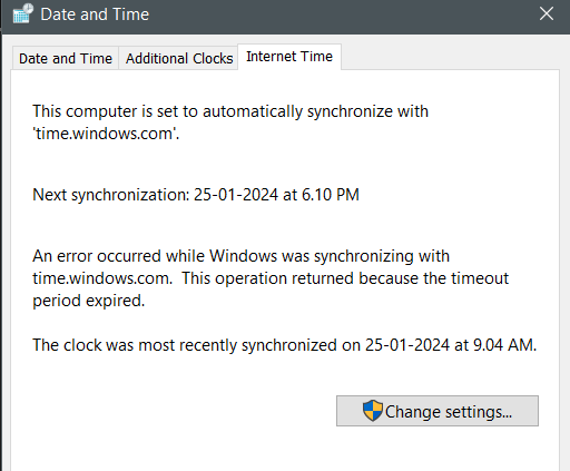

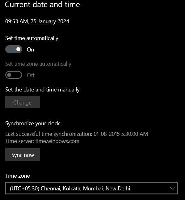

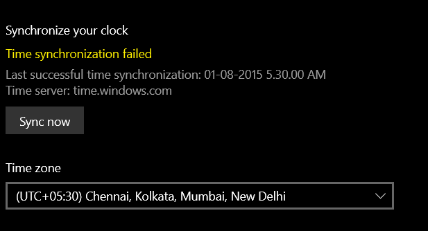

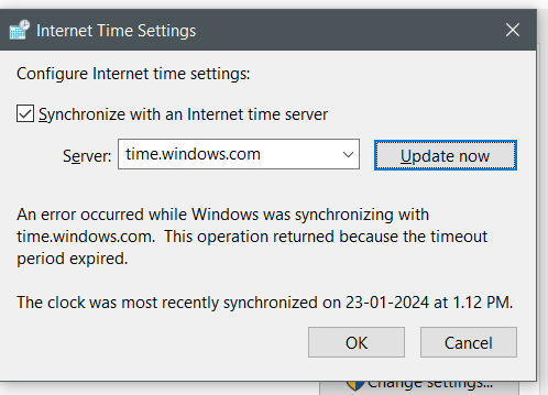

When checked further, I was told to sync my windows clock. However there I am always getting message as "Time Synchronization Failed" Last successful time synchronization was at 01-08-2015 05.30.00 AM. I tried to do it in both servers "time.nist.gov" and "time.windows.com"
In "Internet Time Settings" window it says below.
In "Sync Time window" it says as
Python Error is as below

    2024-01-25T04:50:37+00:00
    Hello Kapil,

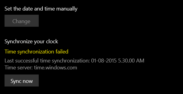

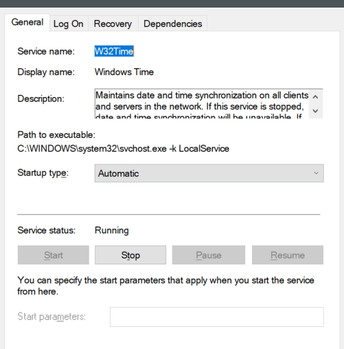

    Thanks for the post. Even though the post was for W11, I tried all 4 steps mentioned however its still same. Below are screenshot of 3 methods. 4th was updates in regedit, I did that but forgot to take screenshot. Issue is still same.
    Step 1
    Step 2
    Step 3:
    Issue:
    2024-03-20T15:44:32+00:00
    thanks alot man!! it was all abt freakinng network provider (WIFI) i just tried to sync time usinng my hotspot and it worked!!
