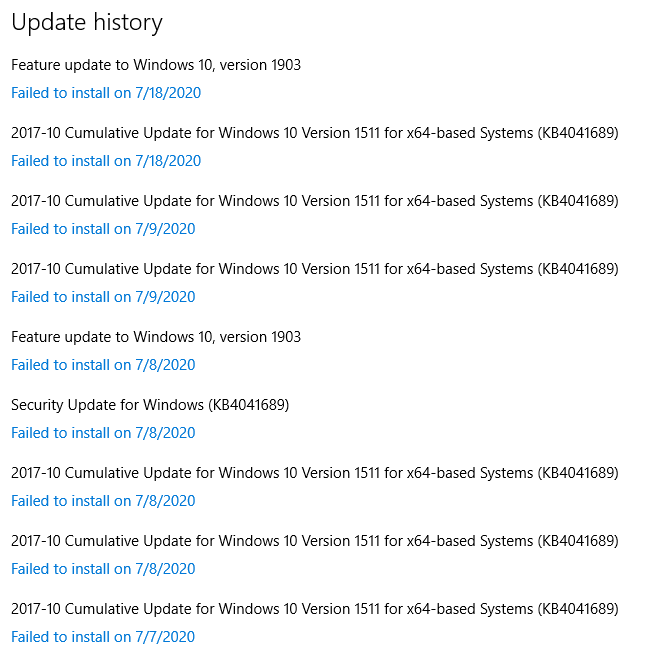

I inherited an older PC from a friend and basically for the past few years, Windows has not been able to complete few specific key updates, which are KB4041689and version 1903 Each time it tries, it will fail, and this means it will continue to try whenever the computer is awake. However, other updates are successful, with the last one being KB4480730 from June 2020. How do I either update my computer or make my computer stop trying to attempt these updates? As of this writing, the C drive has 11.5 GB of free space.
Event viewer shows:
Installation Failure: Windows failed to install the following update with error 0x80070011: 2017-10 Cumulative Update for Windows 10 Version 1511 for x64-based Systems (KB4041689).
I've also tried manually downloading the update and installing it myself but I get this result in the event viewer after it fails to patch.
Windows update  could not be installed because of error 2359302 "" (Command line: ""C:\WINDOWS\system32\wusa.exe" "C:\Users[user]\Downloads\windows10.0-kb4041689-x64_876d2ea04c8495482fcf25fced6a9f299ecbcee4.msu" ")
Here's a screenshot of the update history.

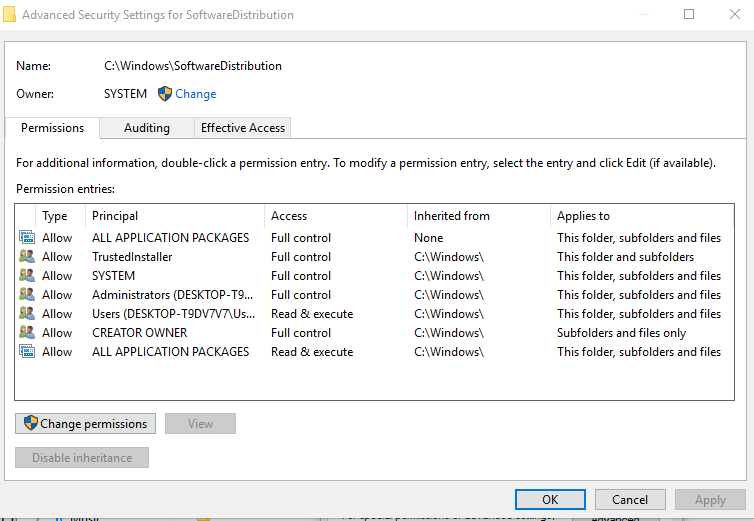

    Thanks for your help. I was able to enter in the four "net stop" commands, but was not able to rename the two folders. For SoftwareDistribution, I'm getting an "Access is denied" error, and even when trying to manually update the folder name via Windows Explorer, I get the error: *"The action can't be completed because the folder or a file in it is open in another program."*I also gave myself full access to the folder but that didn't work.
    When trying to update catroot2 via cmd, I get a "The system cannot find the file specified" error. When trying to manually update the folder name via Explorer, I get the same error as above.
    Please advise.
