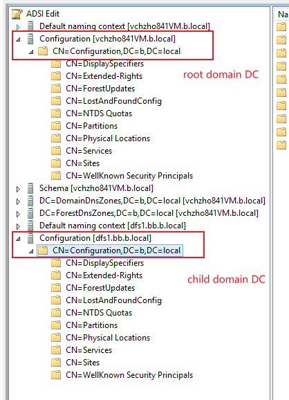

When i use ADSI edit in root domain controller, connect to configuration.
i see Exchange structure like this picture:
But when i use ADSI edit in child domain controller, connect to configuration.
I don't see exchange structure.
When i check replication from root DC to child DC. Everything is OK.
Hope anyone can give me solution..
Thanks guys

    Hello @Cuong. Tao Minh - CTS TSD ,
    I am sorry for the late reply.
    Thank you for your update.
    1.Did you logon the root domain DC and child domain DC with the same credential?
    You can logon the root domain DC and child domain DC with the same credential (such as: root domain Administrator credential) to check if the issue persists.
    2.And if you connect root DC and child DC through ADSI of root DC, and then check if the issue persists.
    Should you have any question or concern, please feel free to let us know.

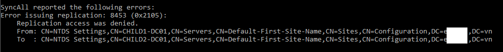

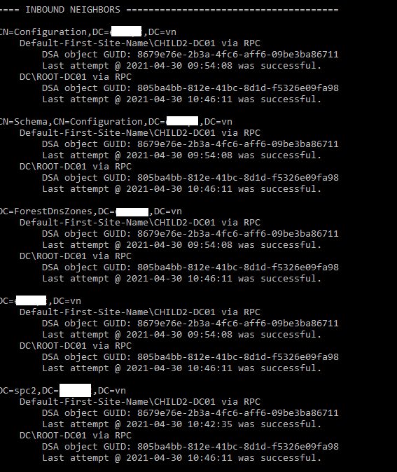

    It looks like there is issue between AD replication.
    Please check AD replication in the entire AD forest.
    1.Make AD replication forcely by running command: repadmin /syncall /AdeP >c:\rep1.txt
    2.Check AD replication by running commands below on PDC in the root domain.
    repadmin /showrepl >c:\rep2.txt
    repadmin /replsum >c:\rep3.txt
    repadmin /showrepl * /csv >c:\repsum.csv
    Check all the result of the commands above, if all the result is OK without any error, it means AD replication is OK.

    I have use command repadmin /showrepl and repadmin /replsum in both root and child domain controller.
    Everything is fine. No error.
