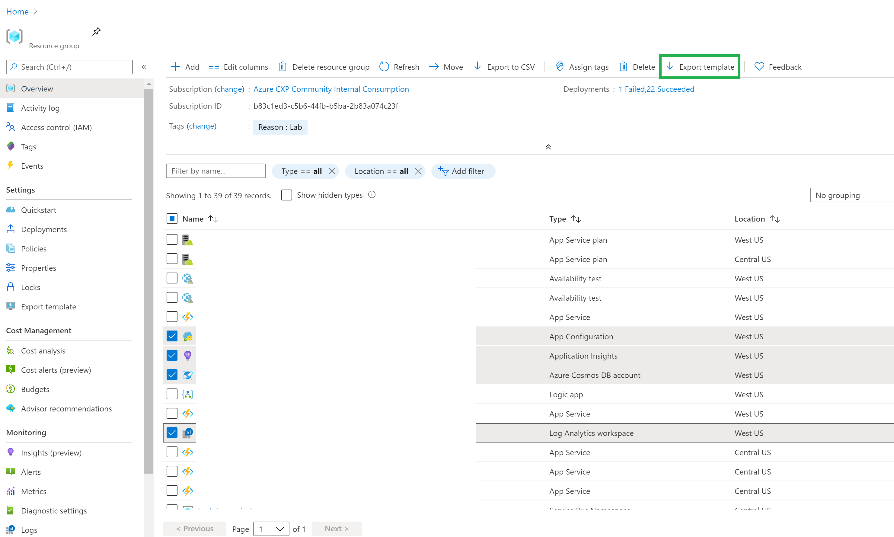

    You can handle this situation by essentially breaking your templates into deployment stages. By selecting specific resources inside the resource group, you will be able to export the templates for just those resources. One way to keep track of which resources are in which template would be to add tags to the resources with that information. You can then filter the list by tag value when exporting templates and ensure that all the resources are defined in an exported template.
