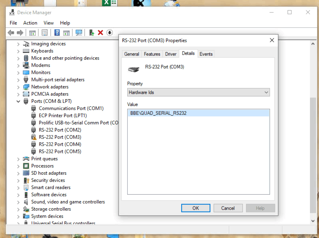

Win 10 Device Manager has a device with an exclamation mark and the error Could not start (Code 10) Object name already used. What exactly is the object name? I am guessing that I need to search the registry for the duplicate. Removing and reinstalling has not corrected the issue.

    The other ports work properly and I have tried removing and reinstalling the entire device several times.
    The question, again, is What property of the device is the "Object Name" so that I can search the registry for the "in use" instance?
    Object Name = ????

    In this case, are the other ports still working normally?
    Try right-clicking and uninstalling the driver from all ports and after that restart Windows, I believe Windows will try to reinstall the whole card again.

    I will collect the information you have requested but can I infer that Object Name = Hardware ID? The device is a 4 port USB to serial adapter that had been working on this same laptop and the other three ports are still working fine. I don't remember when it first misbehaved but there have been several Windows updates since then but no driver updates from the manufacturer.
    I just looked and the Hardware ID is the same on all 4 ports:

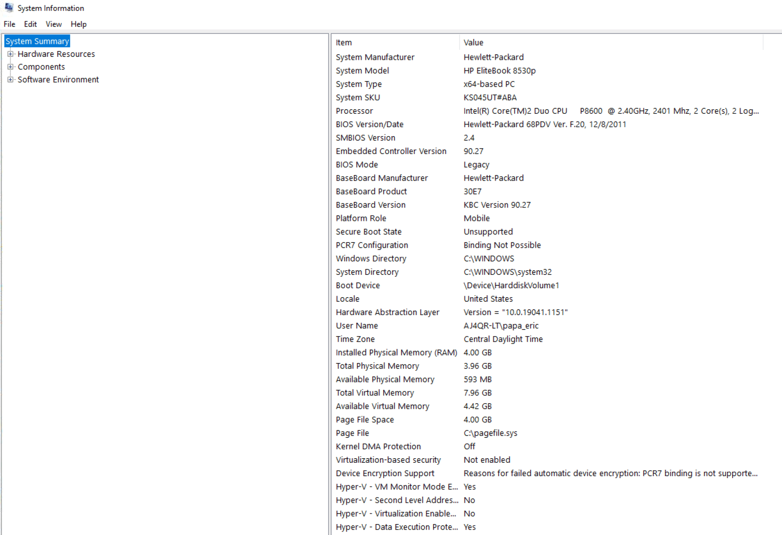

    What is the make and model of your computer? Press Windows+R, type msinfo32 and click OK, then share a screenshot of that screen.
    Please also share the hardware ID of this object with error.
    Right-click on it in Device Manager and select Properties, then go to Details tab, under properties, select Hardware IDs, copy the first row of ID and share please, or a screenshot of that screen too.
