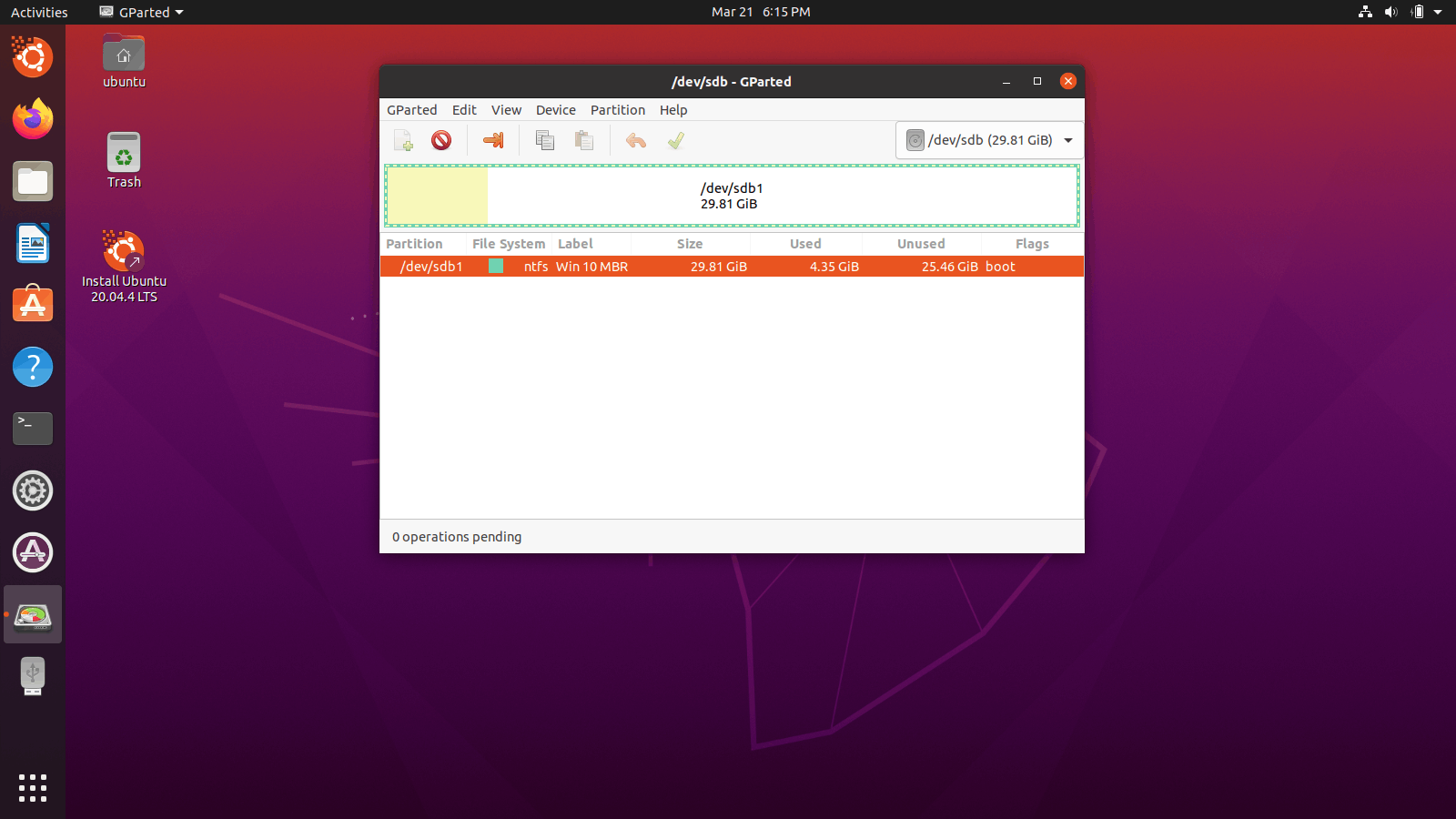

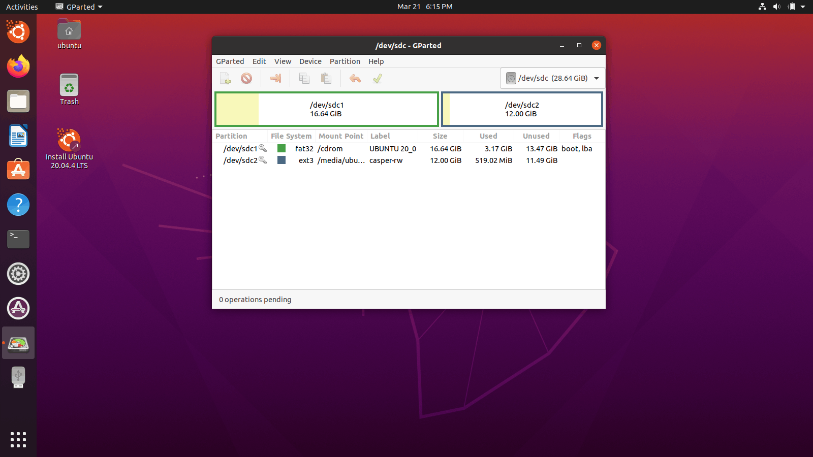

I can boot successfully from a flash drive, using Ubuntu, Linux Lite, gParted and other Linux distributions without problem. I installed a new CMOS battery, re-seated the RAM, initiated a hard shut off and boot; all to no avail.
this is the flash drive that contains Ubuntu (bootable)
This is the flash drive that contains the Windows Installation files

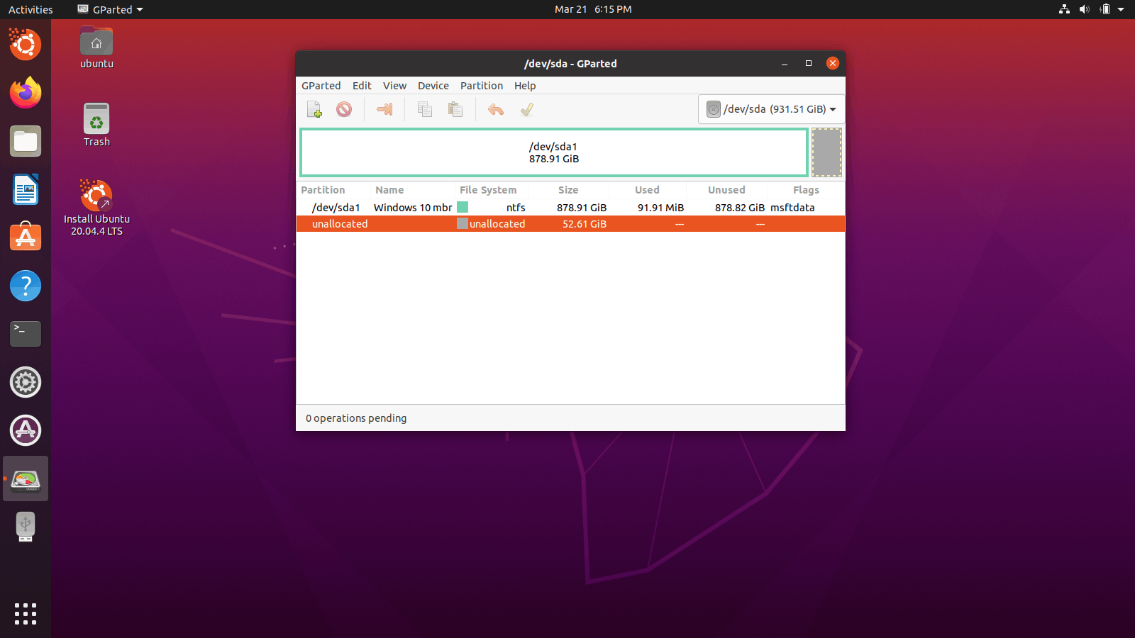

This is the new intenral hhd where I hoped to install Windows 10

    • I used DISKPART to clean the new hard drive, and set (convert) the Partition Type as GPT and file system as NTFS.

                                                                            /dev/sda1 NTFS partition size 878 GB (which I created on this drive)

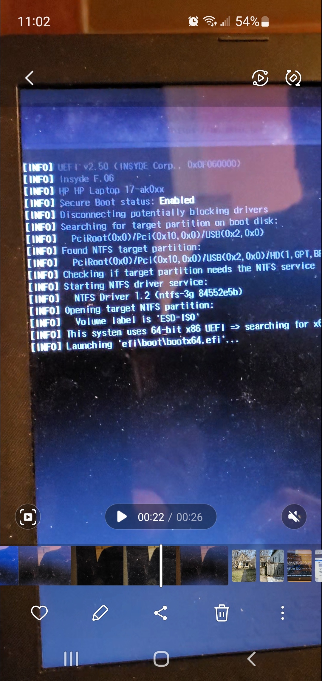

    • Using the bootable flash drive, the screen briefly displays the message below several times for a second each, then returns to the hp Logo where it eventually freezes. The fan speeds up in likely response to experiencing a stress on the CPU to load the Disk  but when the hp Logo freezes eventually, the fan then naturally quiets down

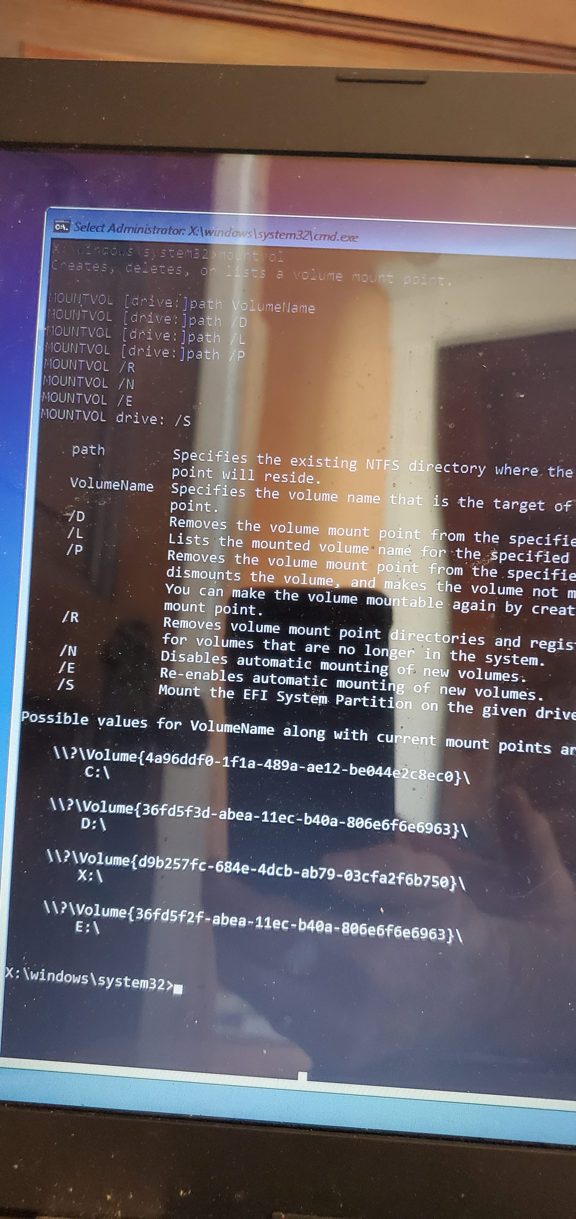

    • I ran the Windows command MOUNTVOL, and got the following results:
