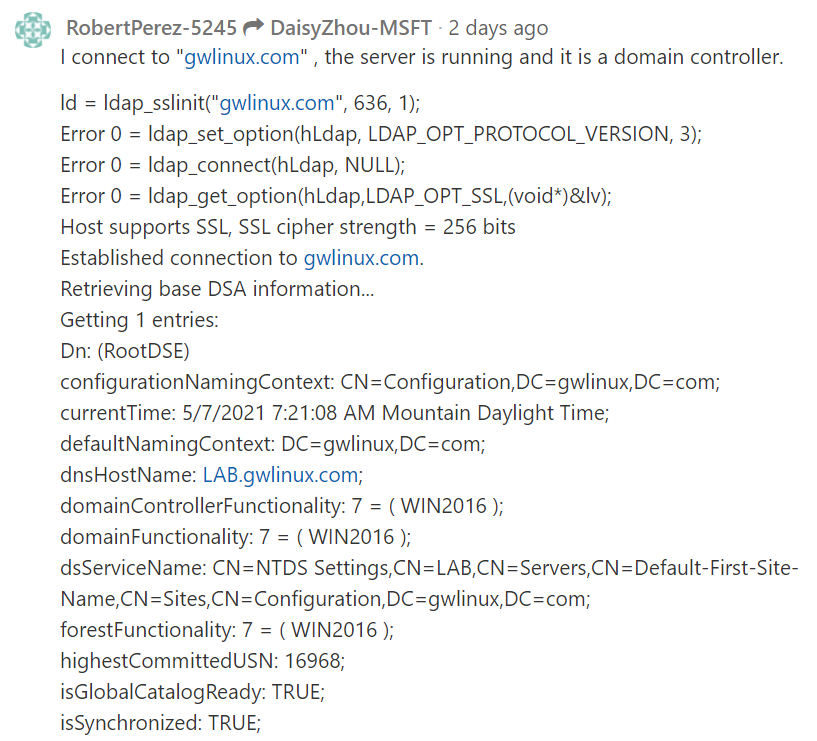

  2. Robert Perez 21 Reputation points
    2021-05-07T03:14:53.327+00:00
    Daisy,
    When I do step # 5 above, the bind, I see :
    53 = ldap_set_option(ld, LDAP_OPT_ENCRYPT, 1)
    res = ldap_bind_s(ld, NULL, &NtAuthIdentity, NEGOTIATE (1158)); // v.3
    {NtAuthIdentity: User='NULL'; Pwd=<unavailable>; domain = 'NULL'}
    Error <81>: ldap_bind_s() failed: Server Down.
    Server error: <empty>
    Even though when I go to a CMD dos window, and do "whoami"
    I see : gwlinux\administrator
  3. Robert Perez 21 Reputation points
    2021-05-07T03:16:24.293+00:00
    Daisy,
    When I do your step # 6, I see:
    Expanding base 'DC=gwlinux,DC=com'...
    ldap_get_next_page_s failed: 1
    Server error: 000004DC: LdapErr: DSID-0C090A5C, comment: In order to perform this operation a successful bind must be completed on the connection., data 0, v4563
    Error 0x4DC The operation being requested was not performed because the user has not been authenticated.
    Result <1>: 000004DC: LdapErr: DSID-0C090A5C, comment: In order to perform this operation a successful bind must be completed on the connection., data 0, v4563
    Getting 0 entries:

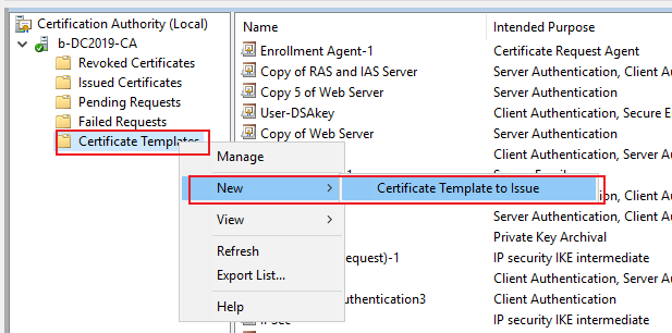

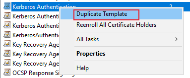

    1.Duplicate a Kerberos Authentication certificate template.
    2.Give "Authenticated Users" read permission and give "Domain Controllers" read and enroll permissions.
    3.Issue this certificate template we just duplicated.
