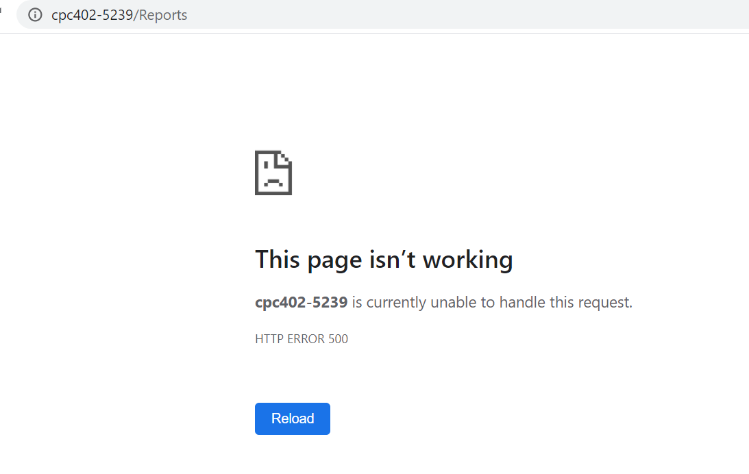

Anonymous authentication was working goof in SQL server 2016 by following below procedure.
https://learn.microsoft.com/en-us/archive/blogs/jameswu/anonymous-access-in-sql-rs-2008
However now I upgraded to SQL server 2019 and SSRS 2019, here after making change as in above url , it says some error in report server, nothing is displayed in report server.
Does SSRS 2019 has different configuration for Anonymous Authentication?

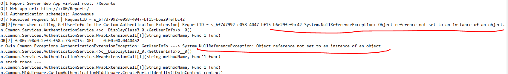

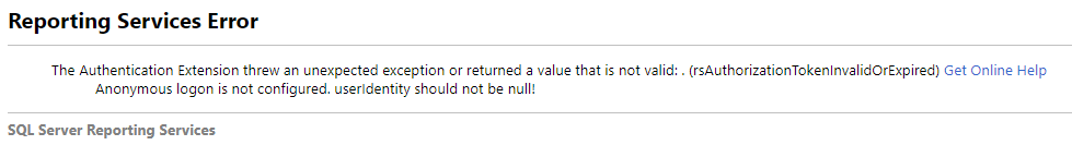

  3. Prashant Andhale 6 Reputation points
    2021-05-07T05:43:56.723+00:00
    Hello Joyzhao-MSFT,
    Thank for your reply.
    I have attached here log and procedure I followed for Anonymous authentication. Your support is appreciated.
    Log below:
    2021-05-07 13:35:28.5793|INFO|1|File Logger created: C:\Program Files\Microsoft SQL Server Reporting Services\SSRS\LogFiles\RSPortal_2021_05_07_13_35_28.log - level Info, will roll at 32 Mb, process id 9200
    2021-05-07 13:35:28.6105|INFO|1|Provider name
    2021-05-07 13:35:28.6105|INFO|1|Container name Microsoft SQL Server Reporting Services Key Container 2010
    2021-05-07 13:35:28.6105|INFO|1|Setting Symmetric Key
    2021-05-07 13:35:28.6261|INFO|1|Setting up Hosted Process State
    2021-05-07 13:35:29.0793|INFO|1|Starting ReportServerWebApp
    2021-05-07 13:35:29.2824|INFO|1|Working directory : C:\Program Files\Microsoft SQL Server Reporting Services\SSRS\Portal
    2021-05-07 13:35:29.2824|INFO|1|Report Server url: http://ykgwomdemo/ReportServer
    2021-05-07 13:35:29.2824|INFO|1|Report Server Web App virtual root: /Reports
    2021-05-07 13:35:29.2824|INFO|1|Web app url: http://+:80/Reports/
    2021-05-07 13:35:29.2824|INFO|1|Web app url: https://ykgwomdemo.southeastasia.cloudapp.azure.com:443/Reports/
    2021-05-07 13:35:29.2824|INFO|1|Authentication scheme(s): Anonymous
    2021-05-07 13:35:31.3137|ERROR|1|Error loading extension:
    System.IO.FileNotFoundException: Could not load file or assembly 'Microsoft.Samples.ReportingServices.AnonymousSecurity' or one of its dependencies. The system cannot find the file specified.
    File name: 'Microsoft.Samples.ReportingServices.AnonymousSecurity'
    at System.Reflection.RuntimeAssembly._nLoad(AssemblyName fileName, String codeBase, Evidence assemblySecurity, RuntimeAssembly locationHint, StackCrawlMark& stackMark, IntPtr pPrivHostBinder, Boolean throwOnFileNotFound, Boolean forIntrospection, Boolean suppressSecurityChecks)
    at System.Reflection.RuntimeAssembly.InternalLoadAssemblyName(AssemblyName assemblyRef, Evidence assemblySecurity, RuntimeAssembly reqAssembly, StackCrawlMark& stackMark, IntPtr pPrivHostBinder, Boolean throwOnFileNotFound, Boolean forIntrospection, Boolean suppressSecurityChecks)
    at System.Reflection.Assembly.Load(AssemblyName assemblyRef)
    at Microsoft.BIServer.Owin.Common.Services.AuthExtensionProvider.LoadAssemblyFromFile(String name)
    at Microsoft.BIServer.Owin.Common.Services.AuthExtensionProvider.LoadAssembly(String name)
    at Microsoft.BIServer.Owin.Common.Services.AuthExtensionProvider.CreateExtensionObject(Extension extConfig, Boolean typeOnly)
    WRN: Assembly binding logging is turned OFF.
    To enable assembly bind failure logging, set the registry value [HKLM\Software\Microsoft\Fusion!EnableLog] (DWORD) to 1.
    Note: There is some performance penalty associated with assembly bind failure logging.
    To turn this feature off, remove the registry value [HKLM\Software\Microsoft\Fusion!EnableLog].
    2021-05-07 13:37:00.4336|INFO|6|Received request GET | RequestID = s_0695ed11-75b7-4e5d-8d41-074dbe1ce695
    2021-05-07 13:37:00.4804|ERROR|6|Error loading extension:
    | RequestID = s_0695ed11-75b7-4e5d-8d41-074dbe1ce695 System.IO.FileNotFoundException: Could not load file or assembly 'Microsoft.Samples.ReportingServices.AnonymousSecurity' or one of its dependencies. The system cannot find the file specified.
    2021-05-07 13:37:00.4804|ERROR|6|Error when calling GetUserInfo in the Custom Authentication Extension| RequestID = s_0695ed11-75b7-4e5d-8d41-074dbe1ce695 System.NullReferenceException: Object reference not set to an instance of an object.
    at Microsoft.BIServer.Owin.Common.Services.AuthenticationService.<>c__DisplayClass3_0.<GetUserInfo>b__0()
    at Microsoft.BIServer.Owin.Common.Services.AuthenticationService.WrapExtensionCallT
    2021-05-07 13:37:00.4804|ERROR|6| fe80::791a:5f2b:f744:5d47%5: GET - 0:00:00.0366273
    Exception: Microsoft.BIServer.Owin.Common.Exceptions.AuthenticationExtensionException: GetUserInfo ---> System.NullReferenceException: Object reference not set to an instance of an object.
    --- End of inner exception stack trace ---
    at Microsoft.BIServer.Owin.Common.Middleware.CustomAuthenticationMiddleware.CreatePortalIdentity(IOwinContext context)
    at Microsoft.BIServer.Owin.Common.Middleware.CustomAuthenticationMiddleware.Invoke(IOwinContext context)
    at Microsoft.Owin.Security.Infrastructure.AuthenticationMiddleware`1.<Invoke>d__5.MoveNext()
    --- End of stack trace from previous location where exception was thrown ---
    at System.Runtime.ExceptionServices.ExceptionDispatchInfo.Throw()
    at System.Runtime.CompilerServices.TaskAwaiter.HandleNonSuccessAndDebuggerNotification(Task task)
    at Microsoft.BIServer.Owin.Common.Middleware.RequestLoggingMiddleWare.<Invoke>d__2.MoveNext()| RequestID = s_0695ed11-75b7-4e5d-8d41-074dbe1ce695
  4. Joyzhao-MSFT 15,636 Reputation points
    2021-05-07T07:55:36.36+00:00
    Hi @Anonymous ,

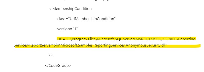

    From the error report, the specified file cannot be found. I think it may be that the content in the configuration file needs to be modified. From what I have found so far, the URL path in the configuration file has changed.
    The URL path in the original configuration file:
    Url="D:\Program Files\Microsoft SQL Server\MSRS10.MSSQLSERVER\Reporting Services\ReportServer\bin\Microsoft.Samples.ReportingServices.AnonymousSecurity.dll",
    This path has been changed in the 2019 version. Make sure to change the below path according to your ReportServer installation directory(Modify according to your installation path): Url="C:\Program Files\Microsoft SQL Server Reporting Services\SSRS\ReportServer\bin\Microsoft.Samples.ReportingServices.CustomSecurity.dll"/>
    You could refer to the following link for reconfiguration, which is likely to resolve the error, please check carefully: Reporting Services Custom Security Sample for Power BI Report Server and SQL Reporting Services 2017. This configuration is suitable for SSRS2019.
    Hope this helps.
