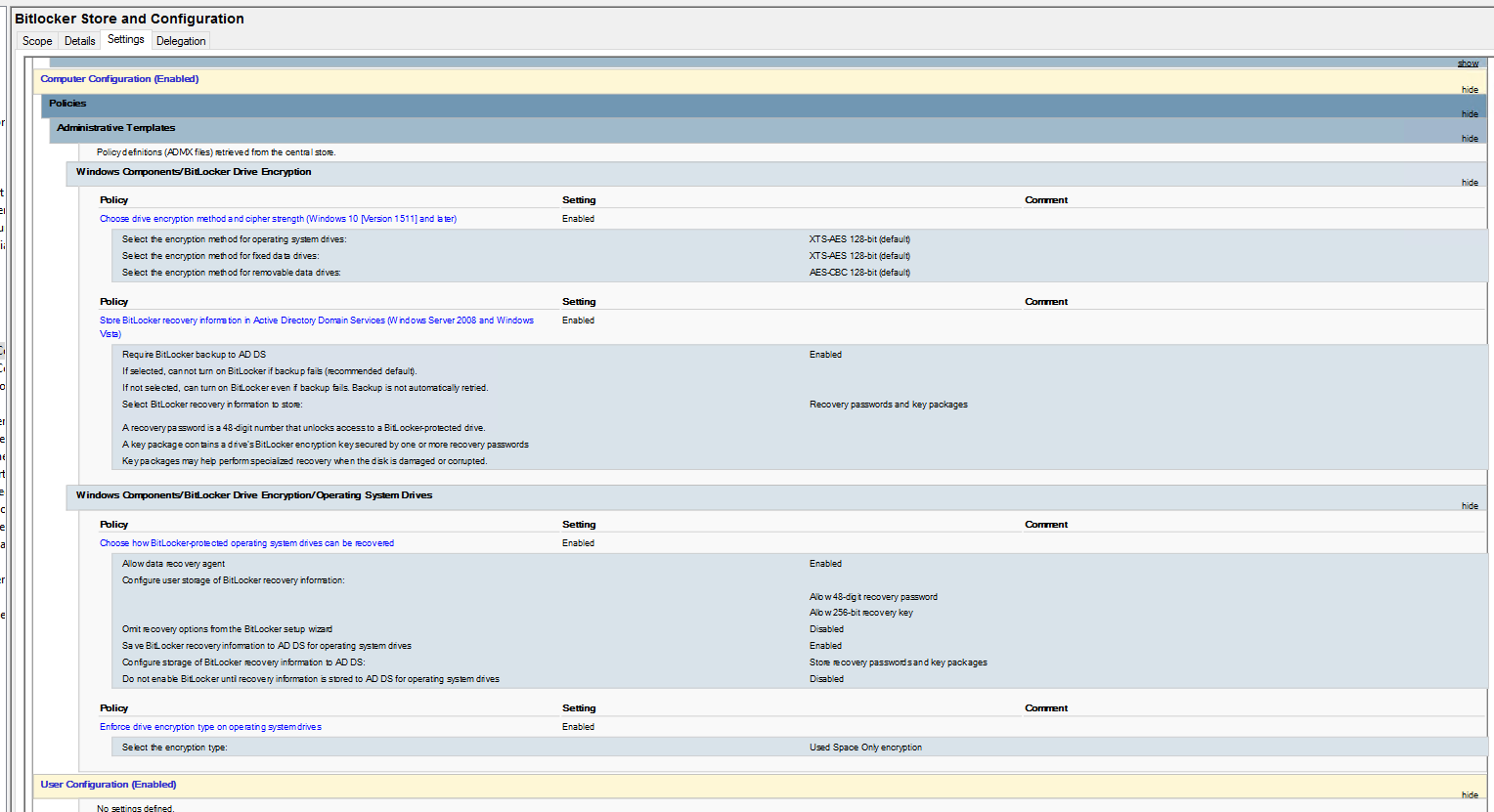

A few days ago I installed Bitlocker roles on domain controllers and I created my first GPO to manage and store bitlocker of company laptop.
This gpo only works with laptops on which I have enabled the bitlocker after the deployment of the GPO.
Here you can see my GPO that permit domain computers to save Bitloker key on Active Directory.
I would save on AD recovery key of all laptops/computers that I enabled Bitlocker before to create and deploy the "new management of bitlocker key".

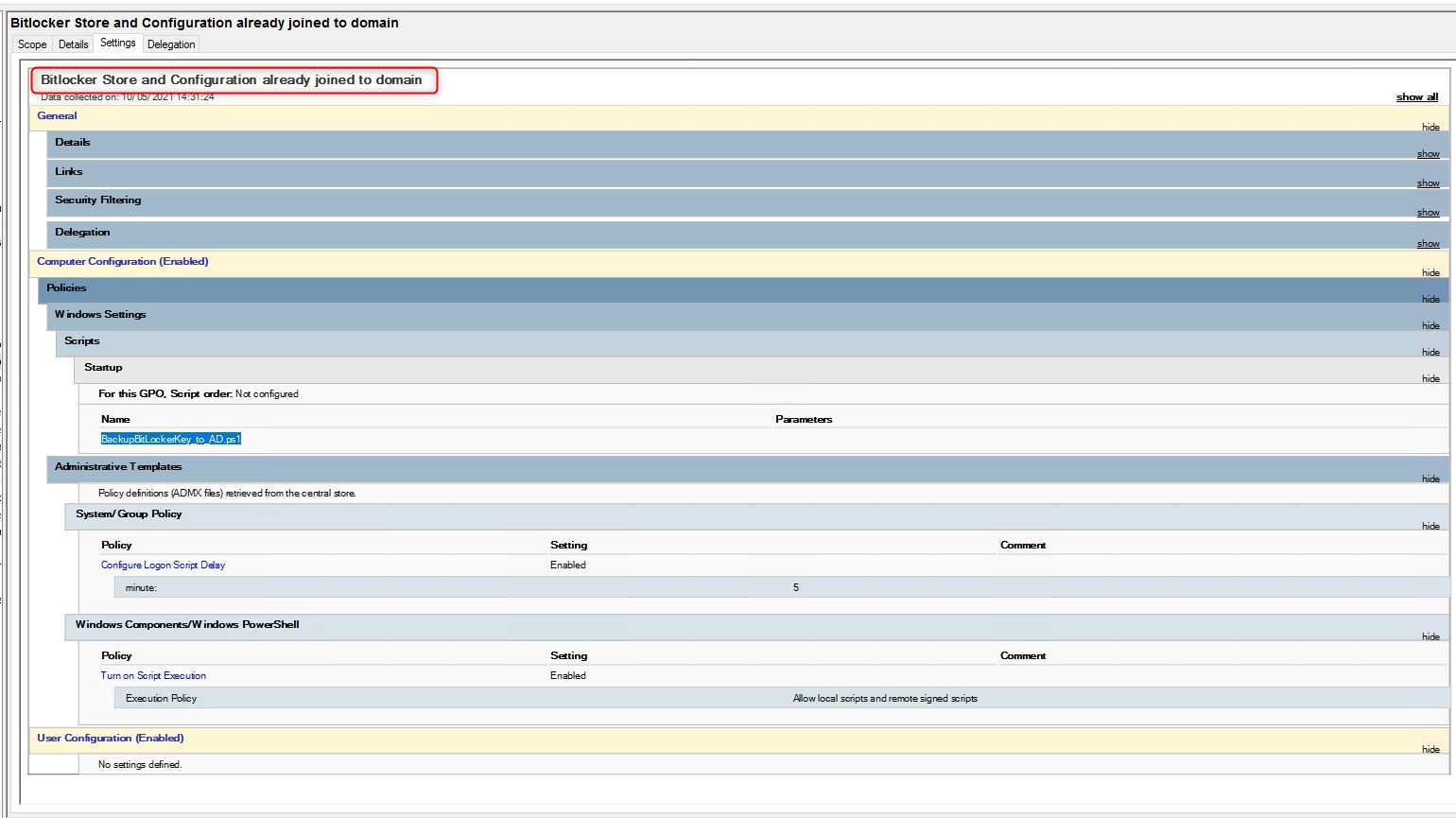

I created a second GPO that runs a simple PowerShell Script to send recovery key to domain controllers.
Here, you can see the second GPO to backup recovery keys:
The PS script is stored in \company.local\SysVol\company.local\Policies{9CDB32A0-1534-4B3D-86D1-F96974CB0E70}\Machine\Scripts\Startup
PowerShell script is:
$keyID = Get-BitLockerVolume -MountPoint c: | select -ExpandProperty keyprotector | where {$_.KeyProtectorType -eq 'RecoveryPassword'}
Backup-BitLockerKeyProtector -MountPoint c: -KeyProtectorId $keyID.KeyProtectorId
I configured security settings that permit to "Domain computer" and "Authenticated User" to read and execute this script.

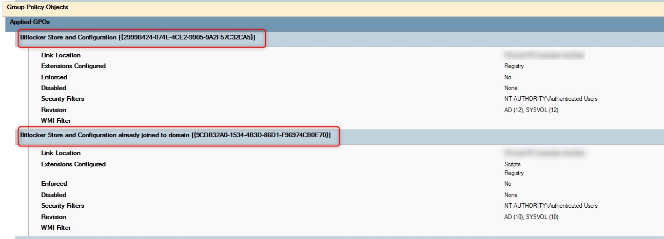

    For the GPO not applying issue, it will be helpful if you can help collect the following information:
    1, When some of the computers not applying the policy well, some are good, right?
    2, Where did you link the GPO, on the domain level or the OU level?
    3, Did you configure the security filter?

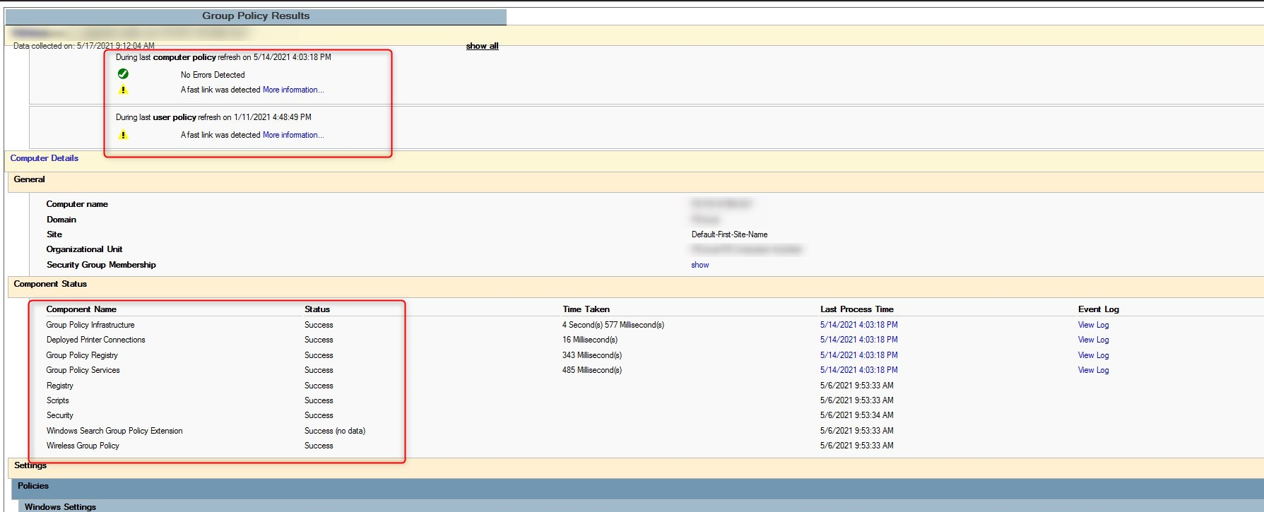

    4, Please run cmd as administrator and run command: gpresult /h report.c:\html, check if there are any errors and if the GPO was applied?
    If possible, please share a screenshot here.
    For the bitlocker recovery key setup, I'm afraid i can't give you more professional advice.
    You may create a new thread and add the win10 setup tag to get more professional advice.

    Hi @Anonymous
    I waited some days and I noted that now these two laptop backup their bitlocker recovery key on Active Directory.
    In this moment I applyed this policy to just to a small Computer OU (There are just 6 laptop in this OU).
    Now all laptop has got their bitlocker recovery key in AD computer profile.
    I noted that these laptop downloaded GPO properly and I do not see errors.
    After that I noted a warning message in gpresult HTML report.
    Link is this one: https://learn.microsoft.com/en-us/previous-versions/windows/it-pro/windows-server-2012-R2-and-2012/jj573586(v=ws.11)?redirectedfrom=MSDN
    This link talk about Fast Startup, but it is not correlated to Windows Server 2016 and Windows 10 Professional. (Inside company there are only Win10 PC and Win2016 server).
