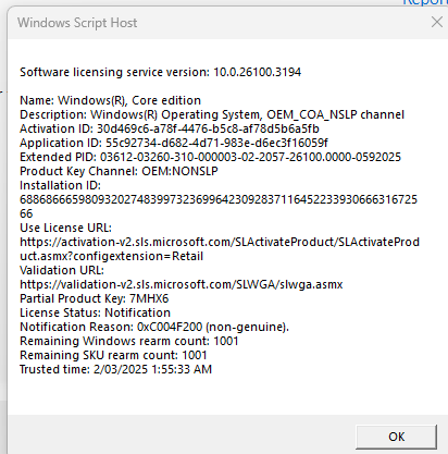

EmilyS726 270.5K Reputation points Independent Advisor
2025-03-01T16:01:55+00:00
No worries, there's no PII in this screenshot.
You have OEM-COA-NSLP license.
This type of license is for builders who don't have capability like big OEM companies (Dell, HP, etc) to embed OEM license to motherboard. So it works like a retail license, but builders must put the sticker on the device that it came with. Look for this sticker on the device somewhere. Typically it is on the back of the PC tower. When you find it, you will see the license key on it.
Then go to Settings > System > Activation > Change product key, key in the license key and it should do the trick.

    2025-03-01T16:00:17+00:00
    Here you go. Not sure if there's any sensitive information shown but if there is please let me know so I can hide it. Also, I have yet to use a different product key.
  3. EmilyS726 270.5K Reputation points Independent Advisor
    2025-03-01T06:18:07+00:00
    Hello.
    Can you please type cmd in the search on the taskbar and hit enter to launch command prompt, then run the following command:
    slmgr /dlv
    Then share a screenshot please. Thanks!
