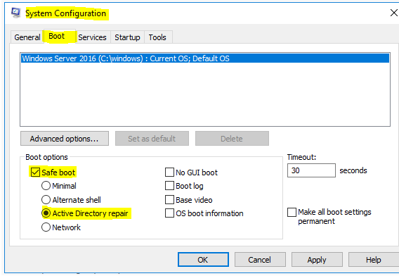

    2021-05-10T15:27:08.247+00:00
    Try logging on DSRM mode

    2021-05-11T02:53:22.363+00:00
    Hello @Braden ,
    Thank you for posting here.
    How many DCs are there in your AD forest?
    If you only have one DC and there is recent backup of this DC, we can try to restore this DC from the recent backup.
    1)Start or restart the DC, press F8 to enter the safe mode and then select “Directory Services Restore Mode”.
    2) Logon the DC with DSRM Administrator account (ComputerName\Administrator or .\Administrator) and password.
    3) Perform the AD DS standard recovery procedure, that is an unauthoritative restore.
    4) Start-> Server Manager->tools-> Windows Server Backup->Recover
    5) Select the location where the backup is stored: This server or A back stored on another location
    6) Select the backup date which should not before the system Tombstone Lifetime, and the default value is 180 days.
    7) Select “System state” in the Select Recovery Type.
    8) Select location for system state recovery:
    Original location with the option “Perform an authoritative restore of Active Directory files”. By default, we do not select this check box.
    Alternate location
    9) Click “Next”, please DO NOT select the check box “Automatically reboot the server to complete the recovery process”.
    10) After the restore process is completed successfully, you can click the restart button. Because if you only have one DC, you do not need to use ntdsutil.exe tool to mark objects as authoritative.
    By the way, would you please tell us how you did it (add a group of users to the Active Directory)?
    Hope the information above is helpful.
