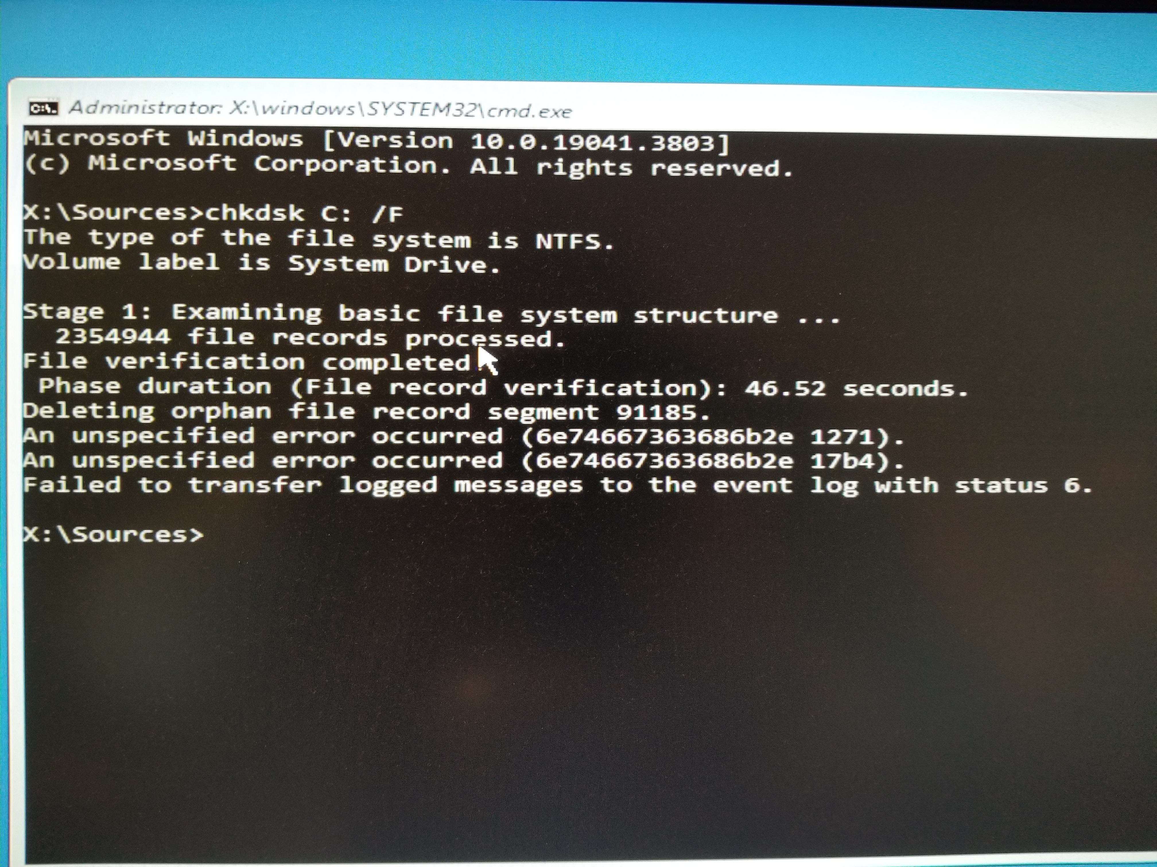

    Aaron,
    Thank you for getting back to me. I entered the recovery environment using the USB installation media and ran "chkdsk C: F." It deleted an orphan file segment but could only run through the first stage of the process before running into two unspecified errors. I have attached a picture of the output below (sorry it's not a screenshot).
    I then restarted my computer after removing the USB installation media and tried to boot into safe mode. It still didn't work. Then I tried to boot normally and the blue screen still occurred.
    I will try the custom installation of Windows 10 from my installation media, but I have two questions before I attempt this procedure:
    1. From what I understand, this process takes all personal files and applications on my C: drive and moves it into a windows.old folder that I can then recover from once a new windows installation is installed. Is there a danger that my personal files and applications might get overwritten by this process? I ask this question because while I have free space on my C: drive, I don't know the size of the new Windows 10 installation. Also, does this procedure touch drives beyond my C: drive? Should I disconnect my other drives so that there isn't a risk of loss?
    2. You stated that I might need to remove my hard disk to backup onto another computer. My C: drive is one of those thin SSDs that you slot directly onto the motherboard of the computer. If I were to backup this drive, would I remove it and get some sort of adapter to allow another computer to interface with it?
    Another question I have regarding file backup: I can access file explorer from the command prompt in the recovery environment using the USB installation media. Could I just copy and paste the contents of my C: drive into one of my external drives to act as a backup without loss of my personal files and applications?
    I will try the custom installation, but at this point, I am wondering if there might be physical damage to certain sectors of my C: drive which might explain these unspecified errors. I guess we will see. Sorry for the abundance of questions; this is all new to me.
