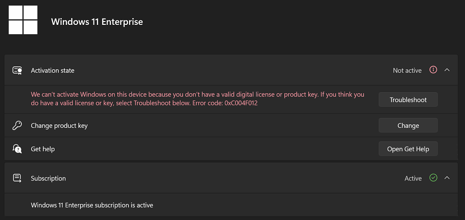

We have an issue with a computer connected to Azure AD, after a user account had their licence upgraded to Microsoft 365 E3 from Office 365 E3, Windows upgraded itself to Windows 11 Enterprise from Pro, and now it has failed activation.
Please help us troubleshoot why Windows has failed activation.
Troubleshoot says make sure you are connected to the Internet, but the device obviously is.

    After upgrading from Office 365 E3 to Microsoft 365 E3, Windows devices are automatically upgraded from Pro to Windows 11 Enterprise with activation failure issues, which is a common occurrence when there is an issue with the Microsoft 365 E3 automatic upgrade feature and activation process. Below are the possible causes and step-by-step solutions:
    Possible causes
    1. License assignment issue:
    The user may not have correctly assigned the Microsoft 365 E3 license, which contains upgrade rights for Windows 11 Enterprise Edition. Activation may fail if the license is not fully enabled or not properly synchronized.
    2. Azure AD activation delay:
    Microsoft 365 E3 uses AAD (Azure Active Directory) - Subscription Activation. Activation is dependent on a successful connection of the device to Azure AD. If synchronization is broken or there are problems with the connection, the activation fails.
    3. Cache or system file issues:
    The device may not have cleared the original Windows Pro activation record, causing activation for Enterprise to fail.
    4. Network or service failure:
    Even if the device is connected to the Internet, activation relies on the Microsoft Activation Server. If the network configuration or firewall is blocking the activation request, an error may also occur.
