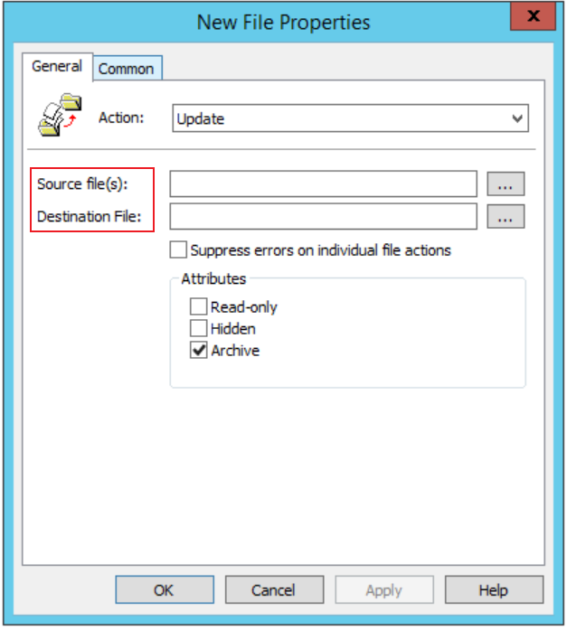

    I know that files can be downloaded to a computer from a domain share without a user account (it's how a GPO does it).
    A: Would you please tell us what gpo setting you mentioned?
    Is it the following GPO setting (copy file from one location to the other location)?
    Computer Configuration\Preferences\Windows Settings\Files
    OR
    User Configuration\Preferences\Windows Settings\Files
    But I don't know how to do this manually (without a GPO).
    The idea I have is to have a task that will download the patches, install them, and reboot as needed. Regardless if a user is logged in or not.
    A: Do you want such a existing task Scheduler that can achieve your requirements?
    I'm guessing if I knew how the GPO does it, I could reproduce it for our task.
    A: Do you mean one GPO can download the patches, install them, and reboot as needed. Regardless if a user is logged in or not? If so, there is no such existing gpo settings to achieve your requirements.
    However, as I mentioned above, you can copy file from one location to the other location via gpo, then if the update files are .msi files, you can install the .msi files via gpo setting below:
