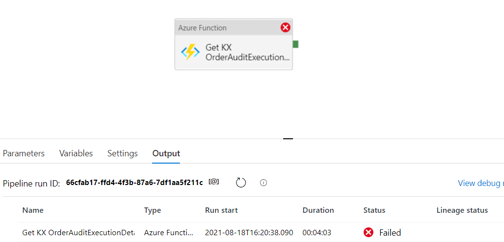

  2. Saikat Sengupta 1 Reputation point
    2021-08-18T17:09:22.497+00:00
    I am also facing this exact same issue when am calling an API endpoint to fetch data and write them in Data Lake. The processing takes around ~7 minutes, but the function throws error in Synapse pipeline within 4 minutes of execution. In some cases, the function completes the processing and write data into Data Lake while at other times it simply don't and the application monitor also don't track any log. As if the execution vanishes without writing any log. This is crazy!
    Did anyone find a solution to this?
    Btw, even the retry doesn't help @Anonymous
