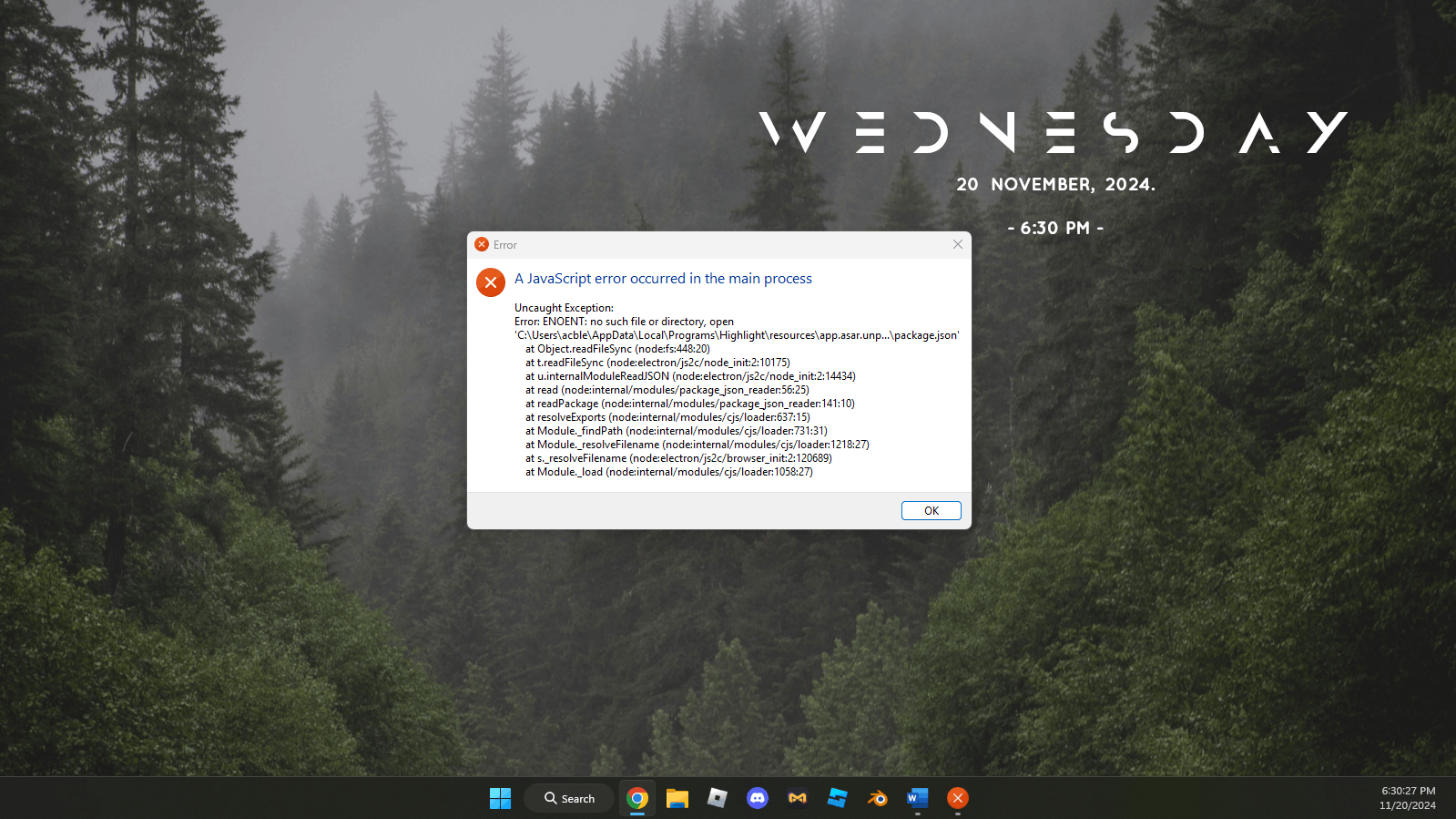

I have a java script error when I boot up my pc and I am not sure why.
2024-11-21T00:34:11+00:00
Whenever I boot up my Dell laptop, I keep getting the error message: "A JavaScript error occurred in the main process." I'm not sure why this is happening or what to do about it. What should I do?

    I understand the issue you have, there is nothing to worry I am here to help, seems that there is a corrupted app file on the PC, however, the error didn't provide the exact application affected, in this case, we need to run Autorun, wherein we will remove unnecessary files which are not in use and are corrupted.
    Go to this link: https://learn.microsoft.com/en-us/sysinternals/...
    Click "Download Autoruns and Autorunsc"
    Then open and run Autoruns
    Delete all highlighted with Pink and Yellow color (If you cannot delete some of those it is okay to skip)
    Method 2. Do clean boot:
    A “clean boot” starts Windows with a minimal set of drivers and startup programs, so that you can determine whether a background program is interfering with your game or program.
    • In the search box on the taskbar, type msconfig and select System Configuration from the results.
    • On the Services tab of System Configuration, select Hide all Microsoft services, and then select Disable all.
    • On the Startup tab of System Configuration, select Open Task Manager.
    • Under Startup in Task Manager, for each startup item, select the item and then select Disable.
    • Close Task Manager.
    • On the Startup tab of System Configuration, select OK. When you restart the computer, it's in a clean boot environment.
    Troubleshooting reference: https://support.microsoft.com/en-us/help/929135...
    Let me know how it goes and I hope that helps.
    Bernard
1 additional answer
    2024-11-23T00:23:20+00:00
    Thank you it has solved the issue. I now know where/wat to do/go when this happens (If ever again)
