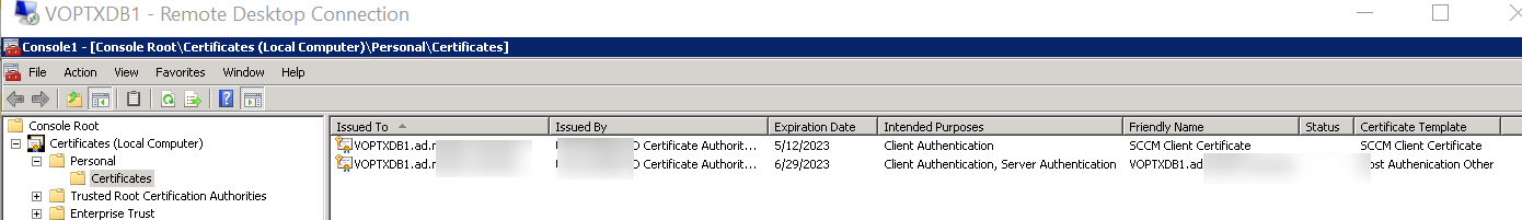

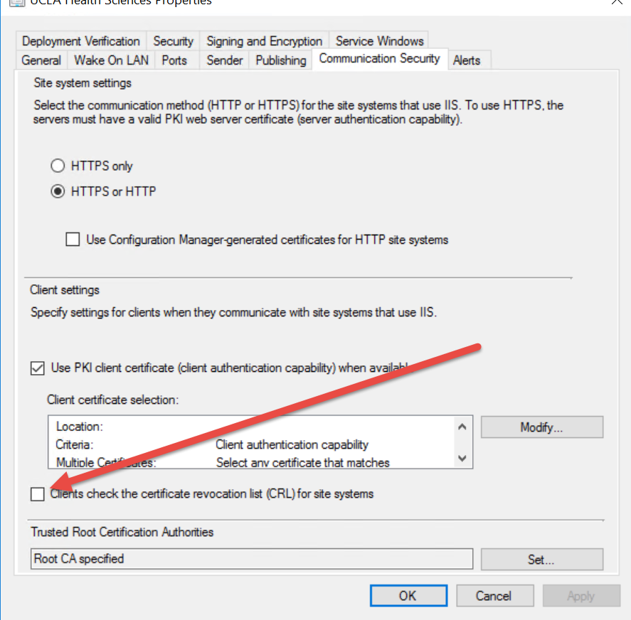

Hello,
The CRL was unchecked on Tuesday, May 11 which is two days ago...
For a machine I am getting an error 0x80072f8f which looks like an issue with the certificate but not sure where to get more information...

Where should I look, I try to reimport the certificate and it looks good ...
Thanks,
Dom

    To avoid any misunderstanding, would you mind helping to double confirm the certificates are met the following requirement: In the Enhanced key usage, it should contain Client Authentication.
    For more details about the requirments: please refer to the client authentication section in this link: https://learn.microsoft.com/en-us/mem/configmgr/core/plan-design/network/pki-certificate-requirements
    Then, we can check the locationservices.log and clientlocation.log on the client side to located the management point through records of the client activity. And view CcmNotificationAgent.log & CCMMessaging.log to check if there's any error of MP communication.
