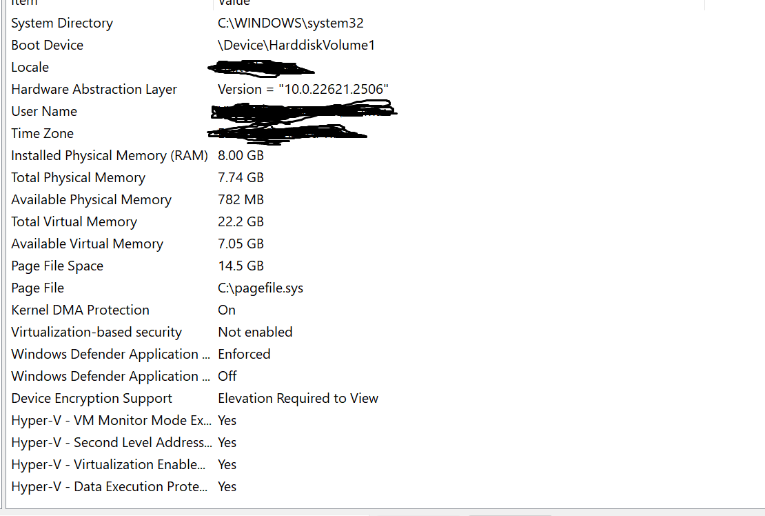

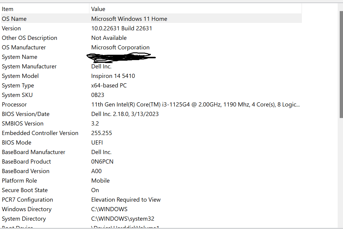

    I need some more information about your laptop, click your Start Button, then just type msinfo and press Enter, please provide a screenshot of the resulting System Information window.
    2024-11-27T14:17:57+00:00
    Does this work?

    Thank you for the screenshot.
    Start your laptop, then on the Dell logo screen, repeatedly press the F12 key.
    On the resulting menu, select 'Diagnostics', and run that full diagnostics test, does it find any problem with the battery or power adapter on your laptop?
