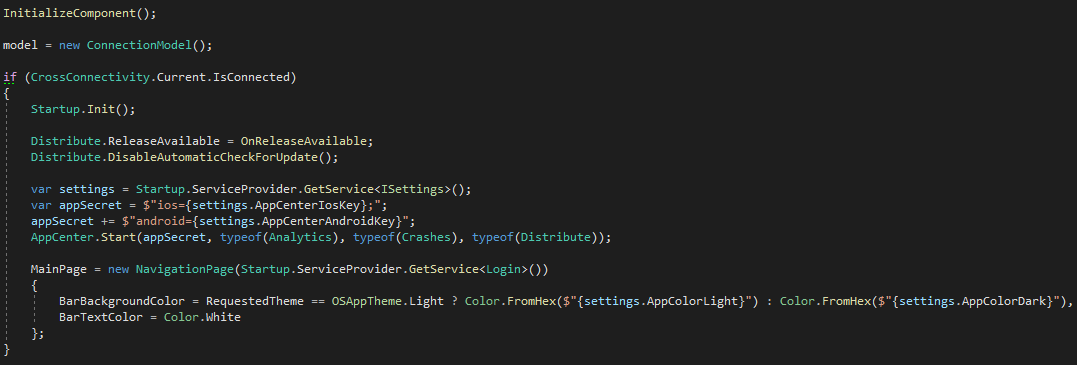

App.cs
Then in App.cs, I have the following code:

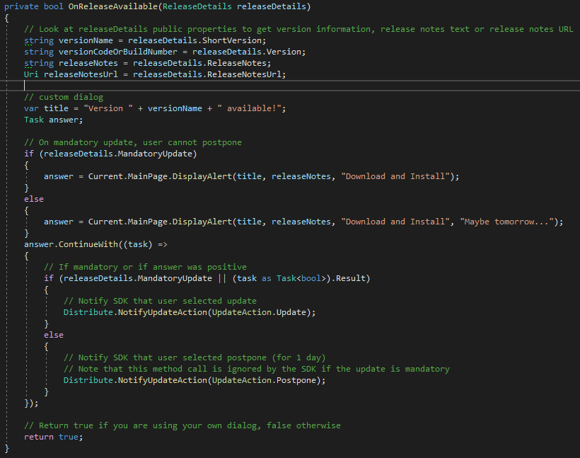

Where OnReleaseAvailable is the following (literally from the docs):
