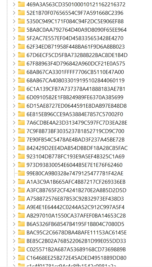

hi, can someone help me with this problem?, i has installed jet the insiders, i have delete it. but there came problems. as minimum runtime. i have seraching for fix the problem, but i have can't fix it jet. the x64 can be install. but the x86 not. i have a core intel i7 vpro. 12core proseccor. see photo's for more detai.

    2024-09-08T10:14:26+00:00
    hey ivan,
    i have tried to find the map, for c ++
    is it right to i must find the map: C:\ProgramData\Package Cache{73F77E4E-5A17-46E5-A5FC-8A061047725F}v14.36.32532\packages\vcRuntimeMinimum_x86.
    but i cant find the map 73F77E4E-5A17-46E5-A5FC-8A061047725F}v14.36.32532
    i have this, but not the right number. thanks for helping!
