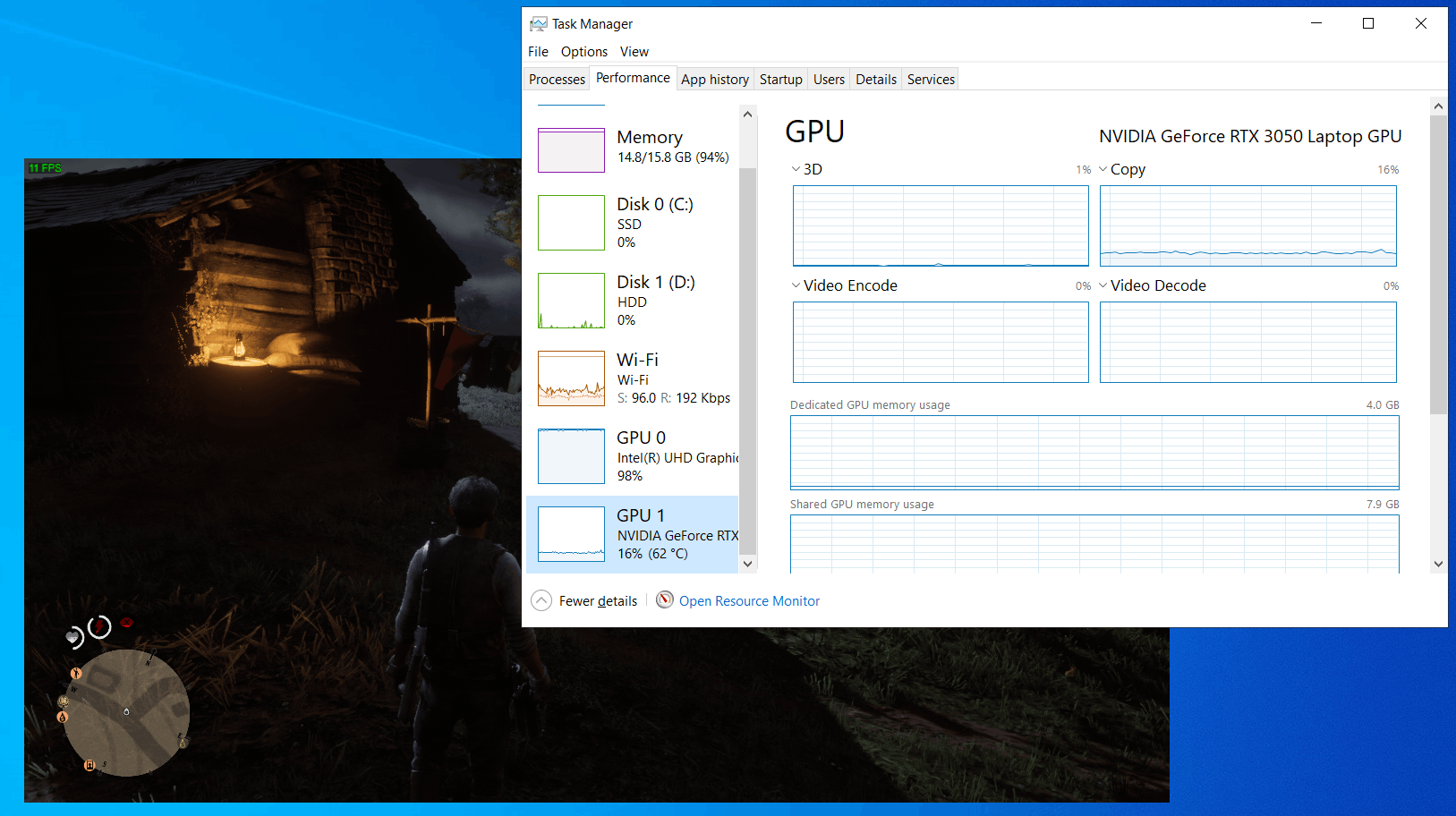

    While running the game, go to the Details tab on Task Manager > Processes tab > Right click the top row and select GPU and GPU Engine to visualize the process that is using the GPU, right click the process > Open file Location. Compare to the file you selected on Graphics Settings to ensure you selected the right .exe file.
    2024-09-19T14:35:33+00:00

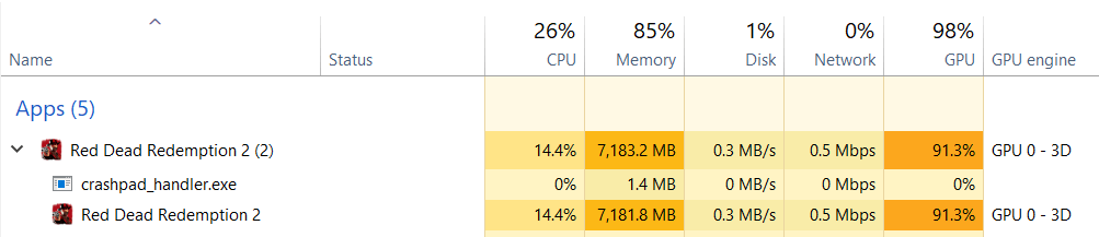

    I guess one of the clear examples without going to rendering things and stuff would be just some good graphics game. Here is how it looks for me when i try to play Red Dead Online

    Did you check on the Task Manager the GPU usage? Can you share an example of an application you set on the graphics settings and how did it work on Task Manager?
