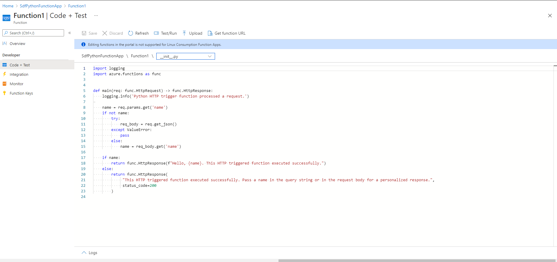

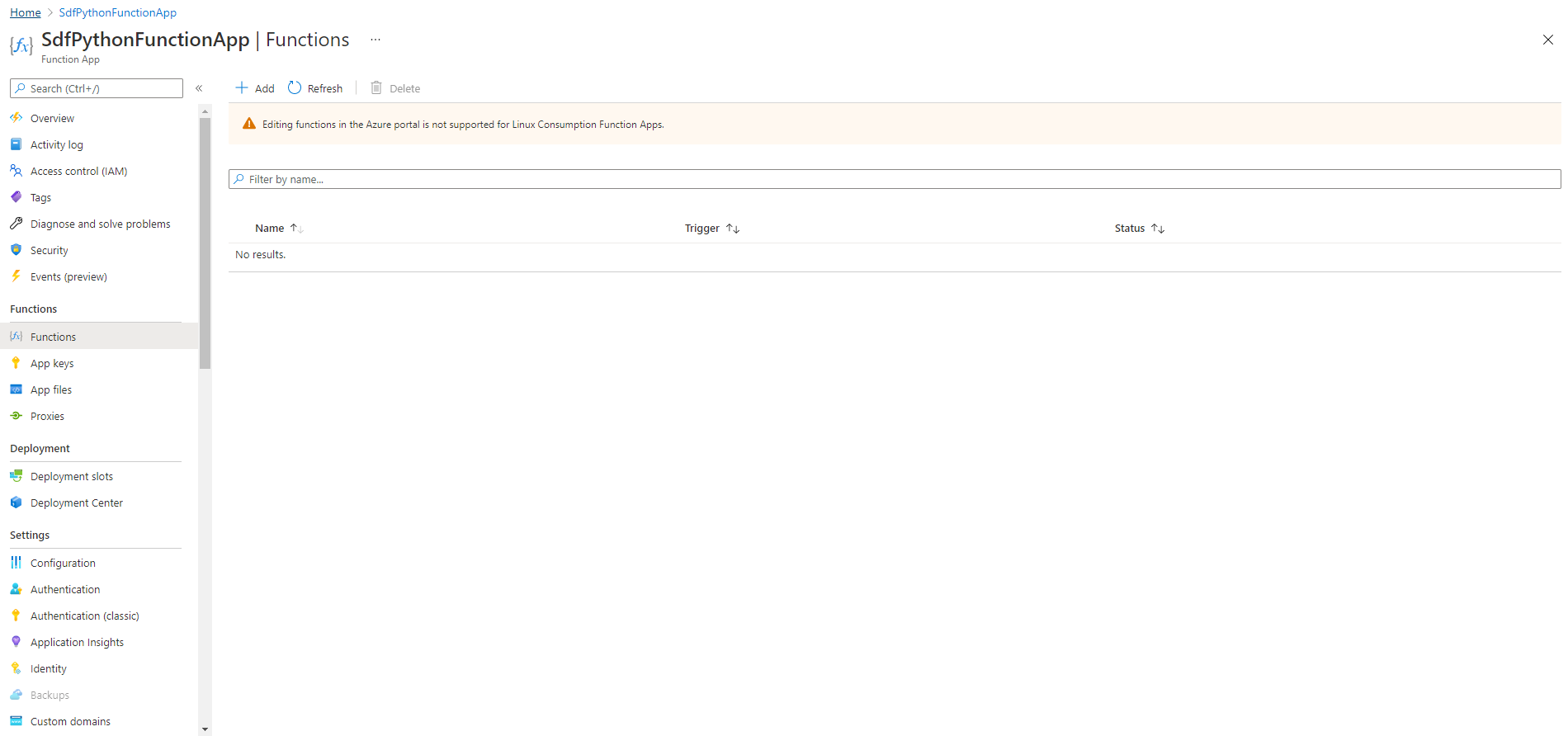

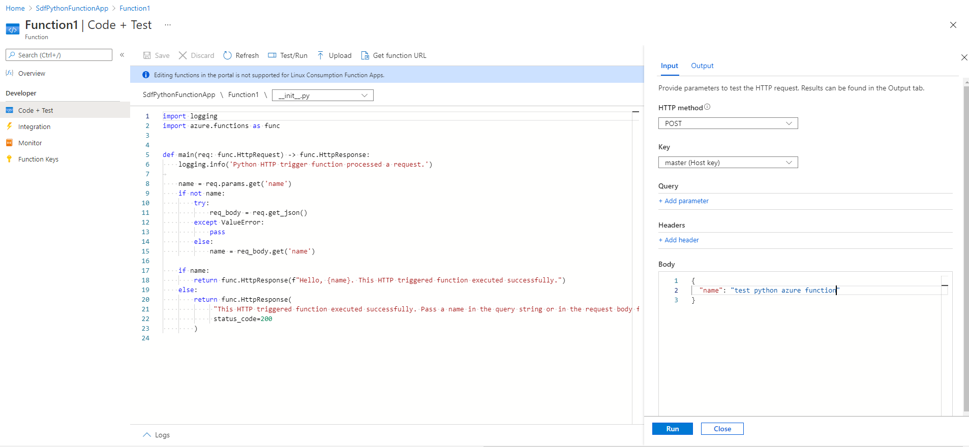

    Thank you for your response. This is exactly what I was looking for. However I believe there is a bug for creating the "init.py" azure function. When I copy paste your request body and send a put request I get a status code "201" for both the C# and Python Azure Function. However when I navigate to azure portal to test the HTTP Trigger function, it runs successfully for the C# one but for the Python I can see the "init.py" script and when I click "Test/Run" in azure portal. The response is "404 Not Found" and when I refresh the page seems like the "init.py" script disappears. Also when I navigate back to the "Functions" page under the Function App using the portal, the newly created function disappears when I click refresh. Have you tried testing the Python function after creation? Or you just assumed it was working when you got the created status code "201" response. Seems that there is some issues with the Python one. I will provide all the screen shots of what I observed. Also sometimes when you create the Python function. It creates it on the portal but when you click it, there is no script. Also sometimes the script names changes to "WarmUp" , than disappears after clicking refresh few times using the Azure portal. Can you please let me know if you notice the same issue on your end. Also if there is something that I missed. I can also provide you a video reproducing's what I have explained above. I did not want to expose my subscription ID and other info in the video. I have attached the screenshots below :
