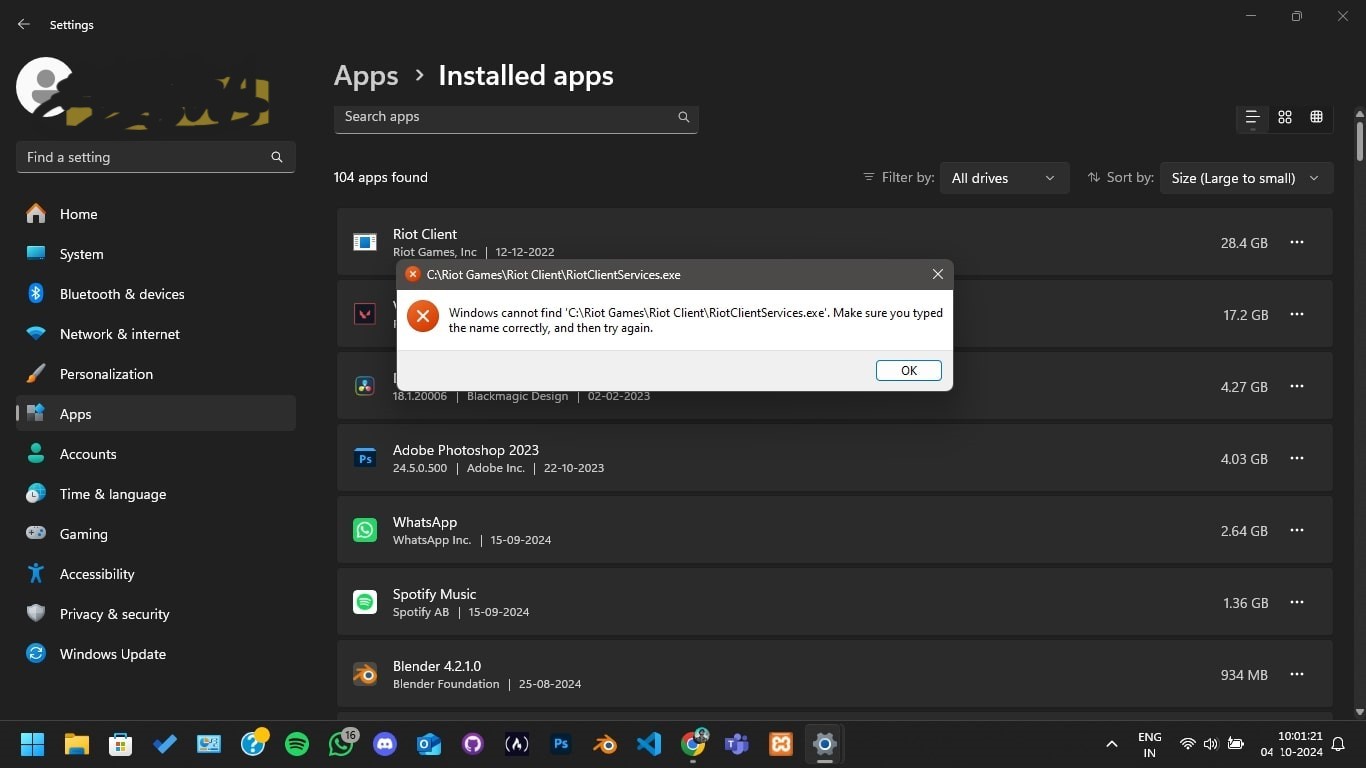

hello there, i am frequently facing some issues while uninstalling the apps form the device.
i dont find the data on the device but still it acquire the required space and it's shown in the settings >apps > installed apps. and if i tried to unistall it, popups came like windows cannot find "the path" , make sure you type it correct......
i tried solving this issue from community section by performing some "sfc /scan......" still i am not able to figure it out. so, please help me out.

    hey Bernard, thank you for your help . i tried the steps you've told but it didn't worked , so i tried uninstalling the applications by using a third party app and it worked.
    previously i removed the app residuals manually from the path so i think that might be the cause i wasn't able to uninstall the application in safe boot mode.
