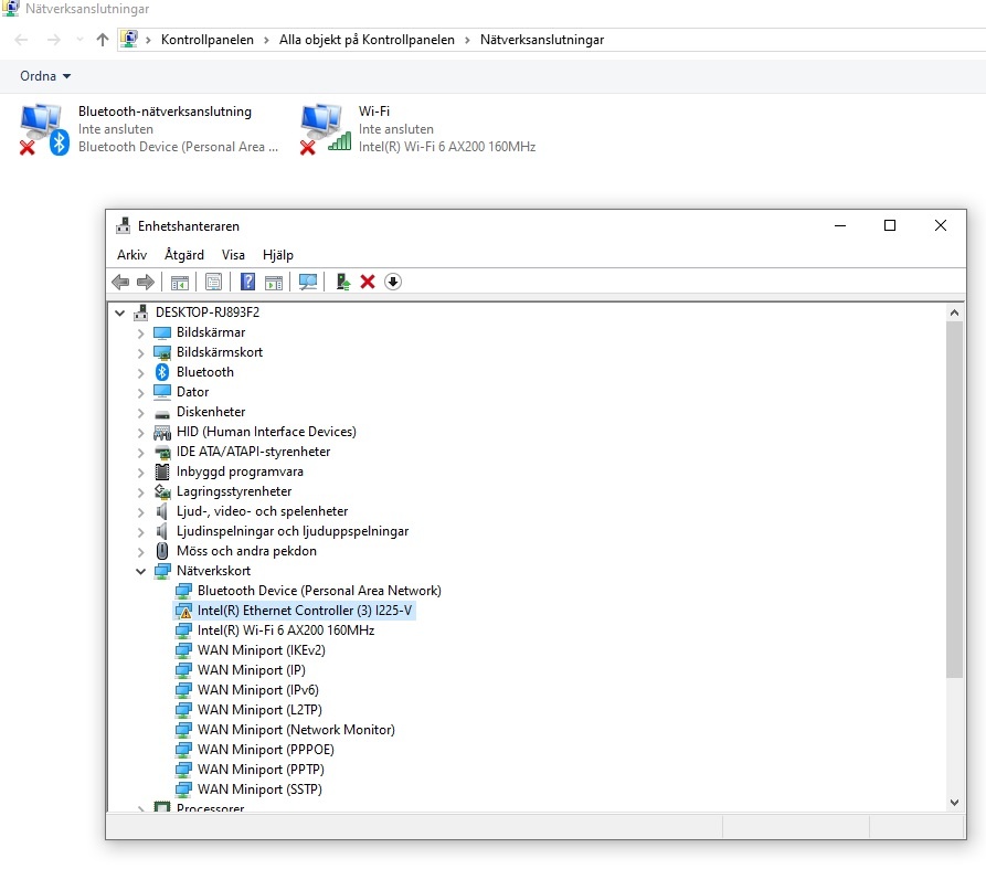

I restarted my pc and ethernet decided to remove itself and stop working. I activated wi-fi that works as normal but i prefer to use a ethernet cable.

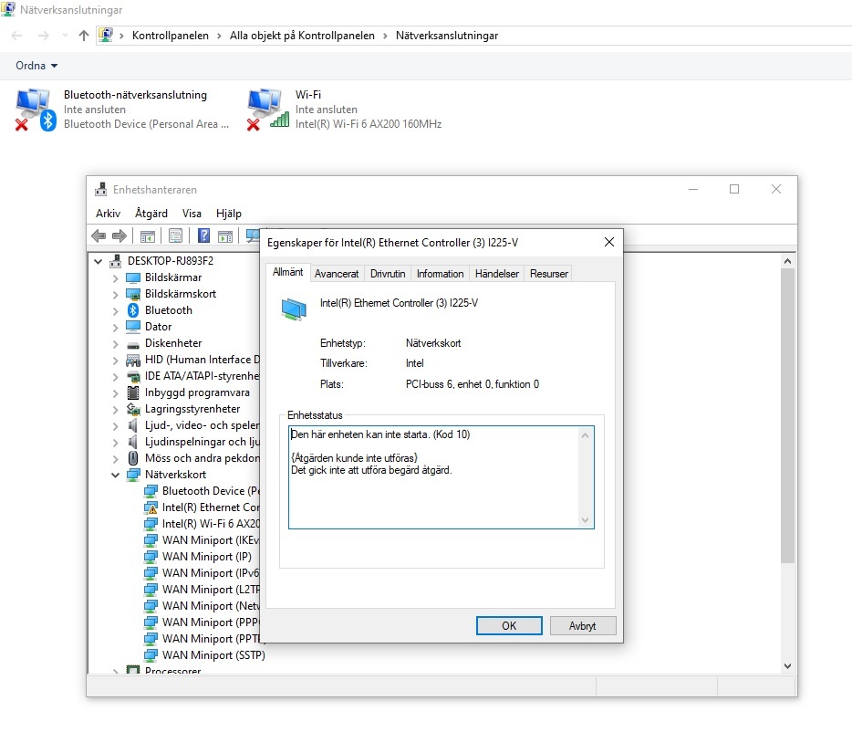

Device manager says ethernet controller cannot start code 10.
It's not the first time this has happend, last time it happend some months ago and i removed the ethernet driver around 8 times and it started to work again but here i am with the same phenomenon, i included some picture if that helps.
Ethernet only shows up if i disable ethernet controller, but is gone when i enable.
