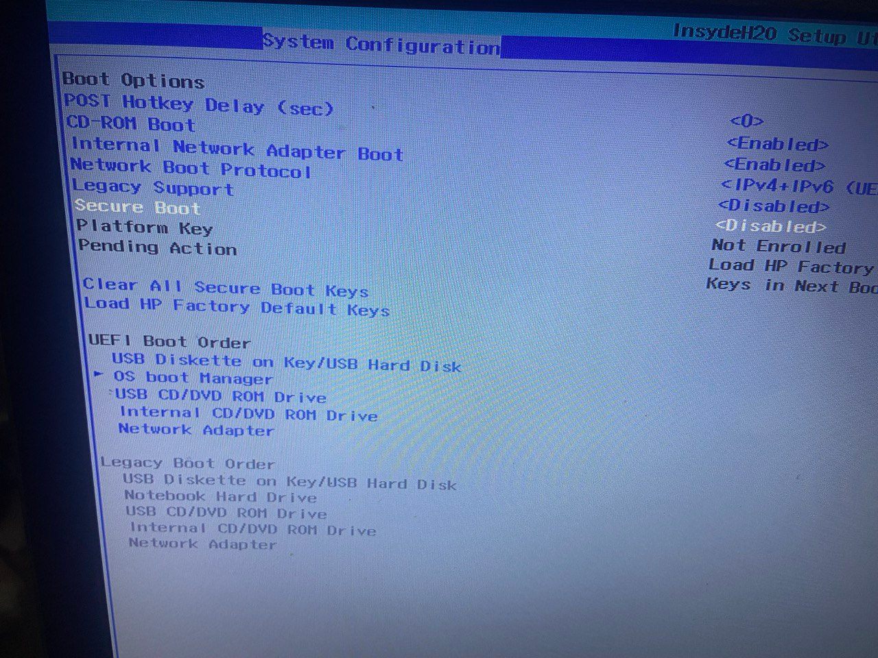

    2024-08-15T07:32:31+00:00
    Thank you for the images.
    Boot your laptop into BIOS, find the Secure Boot setting and disable that, then look for any separate setting to allow your system to boot from a USB to see if that is disabled.
    Save those settings and see if your system will boot from the USB you have created
    @DaveM121
    I have disabled secure boot and loaded HP Factory defaults keys and same result.
  2. DaveM121 891.6K Reputation points Independent Advisor
    2024-08-15T06:52:08+00:00

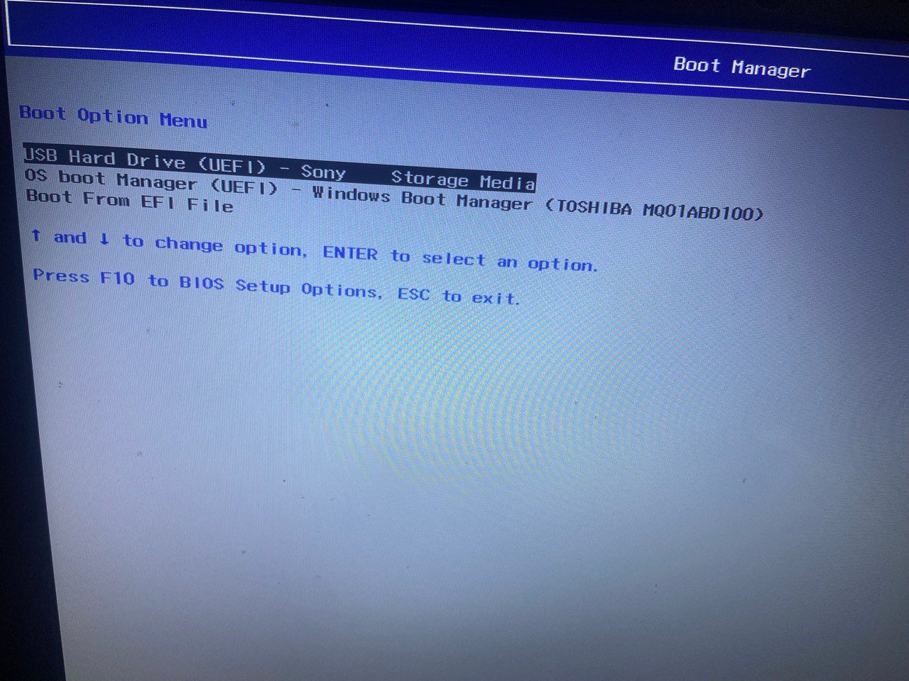

    2024-08-15T06:47:43+00:00
    Hi, I am Dave, I will help you with this.
    Insert the USB, start your laptop, then repeatedly press the Esc key, and on the resulting menu, press F9, you should get a menu to boot from the USB, select that, does your laptop boot up from the USB?

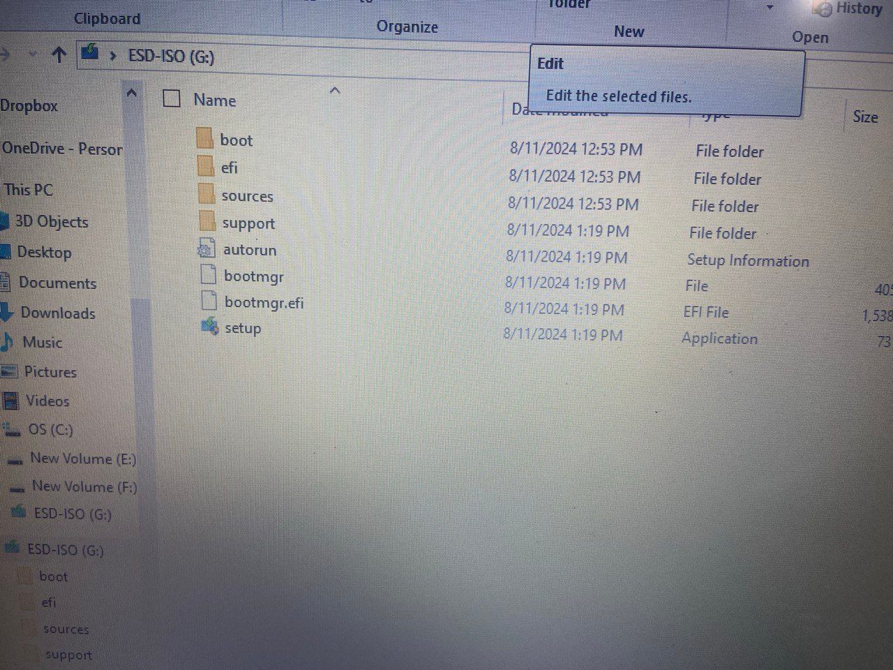

    If not, please provide a screenshot of the contents of the USB you are trying to boot from.
    Hi @DaveM121
    I have done the same procedure as you mentioned above. I pressed F9 and selected and selected Sony USB Flash Drive and the result is same its stuck in boot loop.
    Attached screenshots as you asked.
    Boot Manager
    USB Boot Device
  4. DaveM121 891.6K Reputation points Independent Advisor
    2024-08-13T12:49:03+00:00
