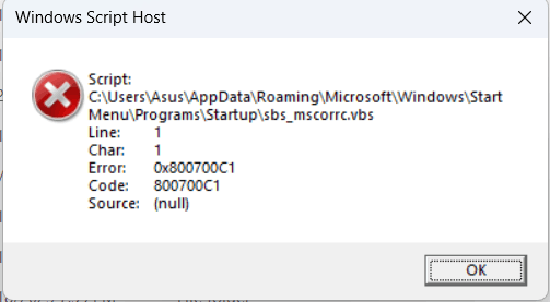

please help me with this startup error

    Hi Raghav, This is Ramesh.
    At line 1 of the script (sbs_mscorrc.vbs) shown in the screenshot, it tries to start an exe or load a DLL. While removing the script from the "Startup" folder of your user profile should stop the error, it's a good idea to inspect the system thoroughly and check if the script is malicious.
    Please run the Farbar Scanner and share your logs on OneDrive.
    1. Download Farbar Recovery Scan Tool (FRST64.exe) https://www.bleepingcomputer.com/download/farba...
    Note: If Microsoft Edge or Chrome mislabels the Farbar Scanner executable as PUA/malware, choose to keep it by tapping … in the bottom bar, choosing Keep, and then choosing Keep anyway in the dialog that appears.
    1. Rename FRST64.exe to FRST64English.exe.
    2. Run the program. Don't check or uncheck any options. Click "Scan".
    3. Upload the two logs, FRST.txt and Addition.txt, to your OneDrive and share the link here.
