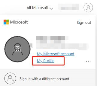

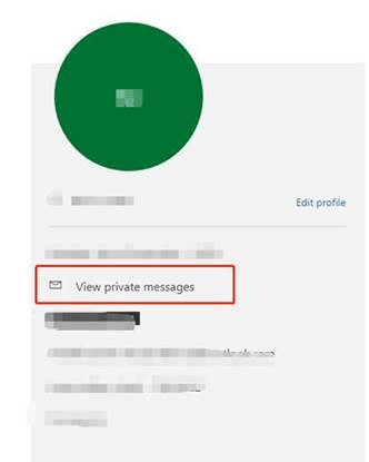

    We understand that you have a problem that your computer will crash, and we need a dump file to analyze the reasons for your blue screen and give further solutions. Please follow the following steps to set up and obtain the dump file:  Go to C:\Windows\Minidump.If you can't find the minidump file, you can set it like this:Press Windows key+S key to enter Control in the search bar to find and open control panel > system and security > system > advanced system settings > advanced startup and recovery > settings, write debugging information, select "small memory dump", and confirm and restart the computer.After setting, if the blue screen appears again next time, go to the default path location C:\Windows\Minidump where you can find the minidump file.Please send it to me by private mail, and I will analyze the cause of the problem for you.You can refer to the following steps to send private messages:
    1. You can send private message through the Messages link at the top right of the page.
    1. Check your sent PM by going to My Profile, and then selecting View private messages on the left pane of your profile page.
