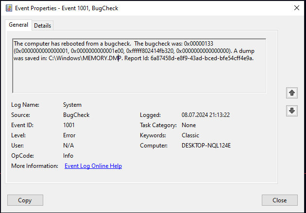

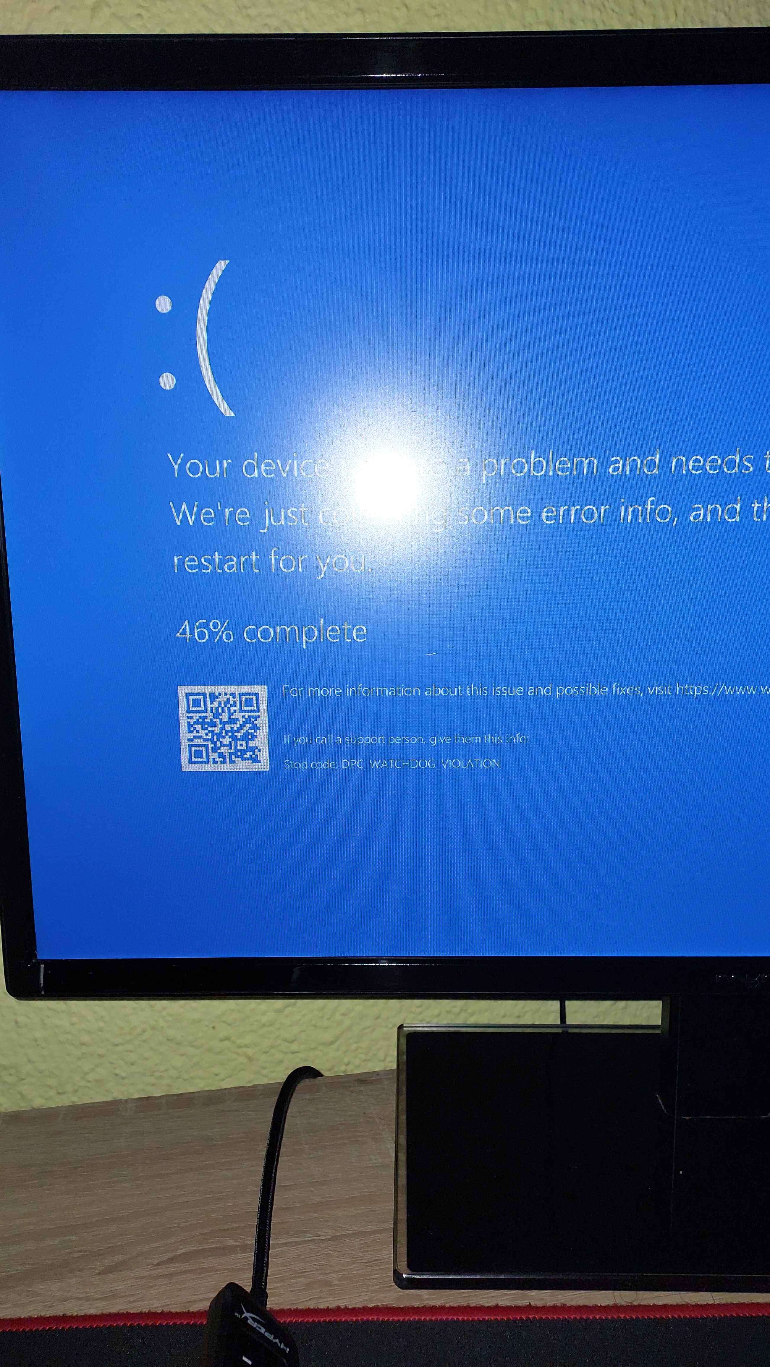

Hi! For some time (I think somewhere around 6 months) I get BSOD, I searched the error code on the internet and I found several causes, I tried several solutions but I haven't really solved the big thing, I try solution X and after some time BSOD appears again...

    The minidump mentions the driver "rt640x64.sys" as the cause of the crash. This driver belongs to your computer's Realtek network adapter.
    I suggest performing a clean installation of the network adapter driver as instructed below.

    Hello there again! First of all i would like to apologize for coming back with a reply after so long, but i haven't had time for my pc in the last few days. Today i got again BSOD same error code (i reinstalled the driver as you said above). I would appreciate if you could give me some advice again
