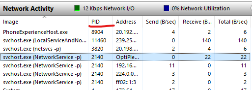

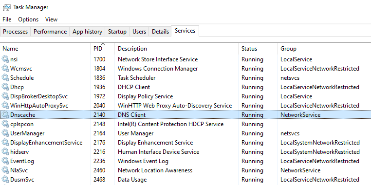

    To determine the service name corresponding to a svchost.exe process, use Task Manager.
    Open Resource Monitor and note the process IDs of svchost.exe processes that consume high network usage.
    Then, switch to Task Manager and click on the Services tab.
    Sort by the PID column and find the service names of the PIDs you noted in ResMon.

    Hello! Thank you for your response and the link to the widgets.
    The corresponding services are:
    SSDPSRV - SSDP Discovery
    Dnscache - DNS Client
    BITS - Background Intelligent Transfer Service
    Windows Push Notifications User_Service_4e8c966
    So how would I stop each of these from taking so much of my network?
  3. Ramesh Srinivasan 171.7K Reputation points Volunteer Moderator
    2024-06-10T04:04:22+00:00
    From that list, you may disable SSDPSRV if you don't use any UPnP devices and are not on a network. DNS client is essential. BITS is needed for Windows Update. Not sure about Windows Push Notifications User_Service. Maybe you can create a batch file that disables SSDPSRV and BITS during gaming and reenable them later.
