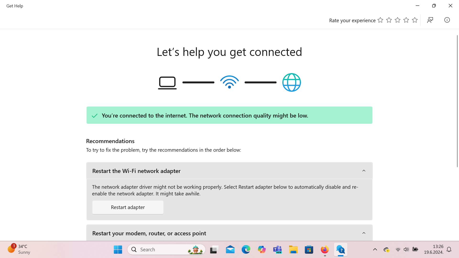

    now it shows this maybe i should go back to the previous version of the operating system on 23H2 and how do i do that?
