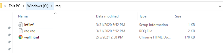

    For example:
    In my lab, the Administrator change the permission on folder C:\req.
