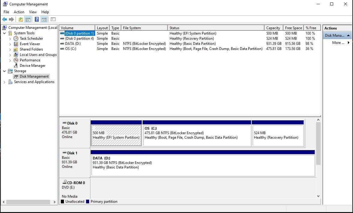

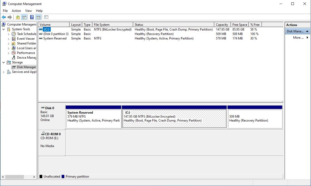

    2024-06-05T13:13:06+00:00
    I'll look into expanding the partition, but from what I'm seeing there should be enough room. I thought the script that Microsoft provided was supposed to take care of everything that needed to happen.
    The script did work fine on systems that had a Type ID of '07' or '27'. It's the systems that have a type of 'Type : de94bba4-06d1-4d40-a16a-bfd50179d6ac' that won't re-enable after the script finishes.
    I'm attaching 4 screen shots. Two are of a system that completed and was able to re-enable WinRE (labeled sys1...) and two that completed but would not re-enable (labeled sys2...). The system with 509MB completed normally (sys1), the system with 524 MB is the one mentioned in the original post (sys2).ImageImage
    System that worked and re-enabled is below:

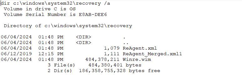

  3. Ramesh 180.1K Reputation points Volunteer Moderator
    2024-06-05T06:48:15+00:00
    Hi Chris,
    The Reagentc command is likely trying to move winre.wim to the OS partition (which is Bitlocker encrypted) because the Recovery partition's size (524 MB) is insufficient.
    You may run the resize script to extend the WinRE partition, and then re-enable WinRE.
    The script is located here: https://learn.microsoft.com/en-us/windows-hardware/manufacture/desktop/add-update-to-winre?view=windows-11#extend-the-windows-re-partition
    Also:
    1. Please post a screenshot of Disk Management (maximized).
    2. Post the output of the following command:
    • dir c:\windows\system32\recovery /a
