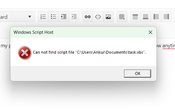

Why Windows Script Can Not find the task.vbs file?
2024-06-15T07:27:45+00:00
i really don't know why is windows sending me this for the past year my pc was working fine and this came out of blue yesterday if you know anyting about this please share it with me.
thanks for your help

  1. Ramesh Srinivasan 173.7K Reputation points Volunteer Moderator
    2024-06-15T07:48:10+00:00
    Hi Aryan,
    Task.vbs may have been added by malware, and subsequently, your antivirus deleted it. The orphaned entry needs to be cleared.
    Please run the Farbar Scanner and share your logs.
    1. Download Farbar Recovery Scan Tool (FRST64.exe)
    2. If the OS language is non-English, rename FRST64.exe to FRST64English.exe.
    3. Run the program. Don't check or uncheck any options. Click "Scan".
    4. Upload the two logs, FRST.txt and Addition.txt, to your OneDrive and share the link here.
    (How-To: Share OneDrive files and folders - Microsoft Support)
    Note: If Microsoft Edge or Chrome mislabels the Farbar Scanner executable as PUA/malware, choose to keep it by tapping … in the bottom bar, choosing Keep, and then choosing Keep anyway in the dialog that appears.
