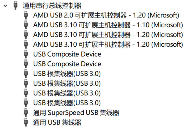

    2024-06-23T07:57:52+00:00
    You can try disabling the AMD USB3.10 eXtensible Host Controller to see if the blue screen symptoms are alleviated. I noticed that you have other blue screen dmp files, I will send you a private message, you can send it to me there.
    I look forward to your feedback, which will help me locate your problem.

    2024-06-22T10:49:11+00:00
    Thanks Aaron.
    But I don't have an NVIDIA USB Host Controller. See below snapshot (sorry that it's not in English).
    Just had another BSOD while I was typing this reply.
    [sad face]
