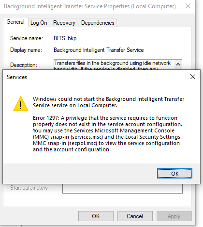

The BITS is stopped and every time I try and run it I get this message. I've tried everything I coould find, including running the troubleshooter which said I had a problem and repaired it, which did nothing. Please help as I can't find anything about this specific BITS error online.
Thanks.
