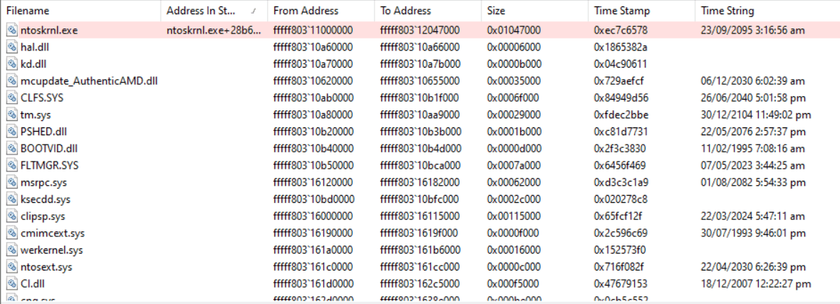

    2024-05-22T18:58:42+00:00
    Hello, I've experienced a bluescreen earlier. I've downloaded BlueScreenView and I've seen that all the minidumps have some interesting time strings. Is this anything to worry about? Is it time for a reinstall?
    I'll attach a photo of BlueScreenView to see what I mean.
    Also, here's the minidump: https://drive.google.com/file/d/1PZLMI6D0XdxxI_Ke97Gak1S0NP7OzqgK/view?usp=drive_link
