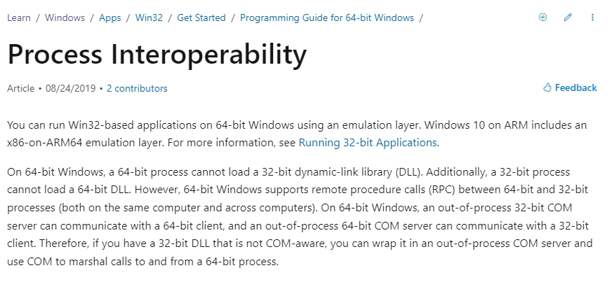

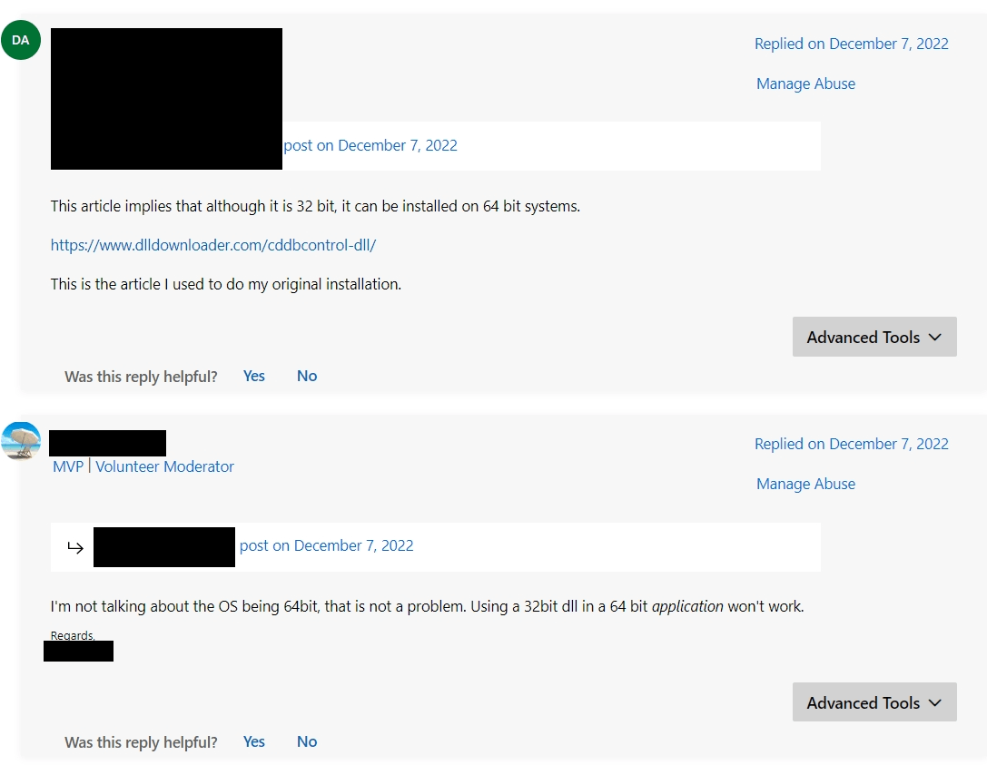

    It is being discussed that the class not registered error could be using the 32 bit of that DLL with 64 bit Office application in below community thread:
    Class Not Registered - Microsoft Community
    Which is clearly stated at:  Process Interoperability - Win32 apps | Microsoft Learn
    So I would like to know where you got this code instruction could you confirm the DLL you are processing are 64bit. Because from my research those resource site referring the cddbcontrol as 32-bit library. Also in programming the context or the source of your code is important for
