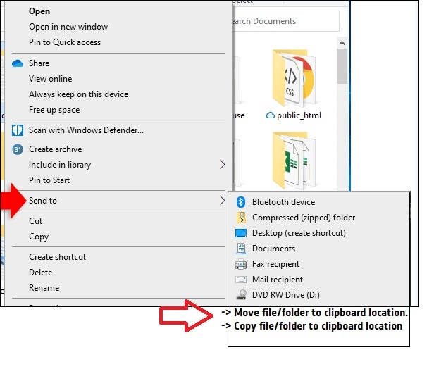

Hello Everyone
I have a problem with copying files instantly in Windows 10.... in other words, how can I create a shortcut that would enable me to use the SendTo menu (right mouse click option: Send To) and send the file to a previously copied foder location in the clipboard? I.e. I have a folder location where I want to upload files, I copy the access path to memory, then find the file I want to transfer or copy there via File Explorer, right-click on the file, select SendTo and e.g.: click on the option "Move file/folder to clipboard location" or "Copy file/folder to clipboard location". - job done.

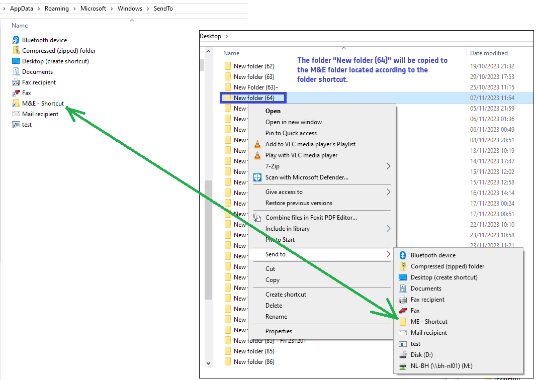

    In the SendTo directory on C drive itself (accessed via RUN/shell:sendto) or via C:\Users\user_name\AppData\Roaming\Microsoft\Windows\SendTo
    I can paste any folder shortcut into the folder and it works. A SendTo menu appears with the shurtcut links where I can send the files, but I don't know how to make a shortcut to get the location from the clipboard location.
